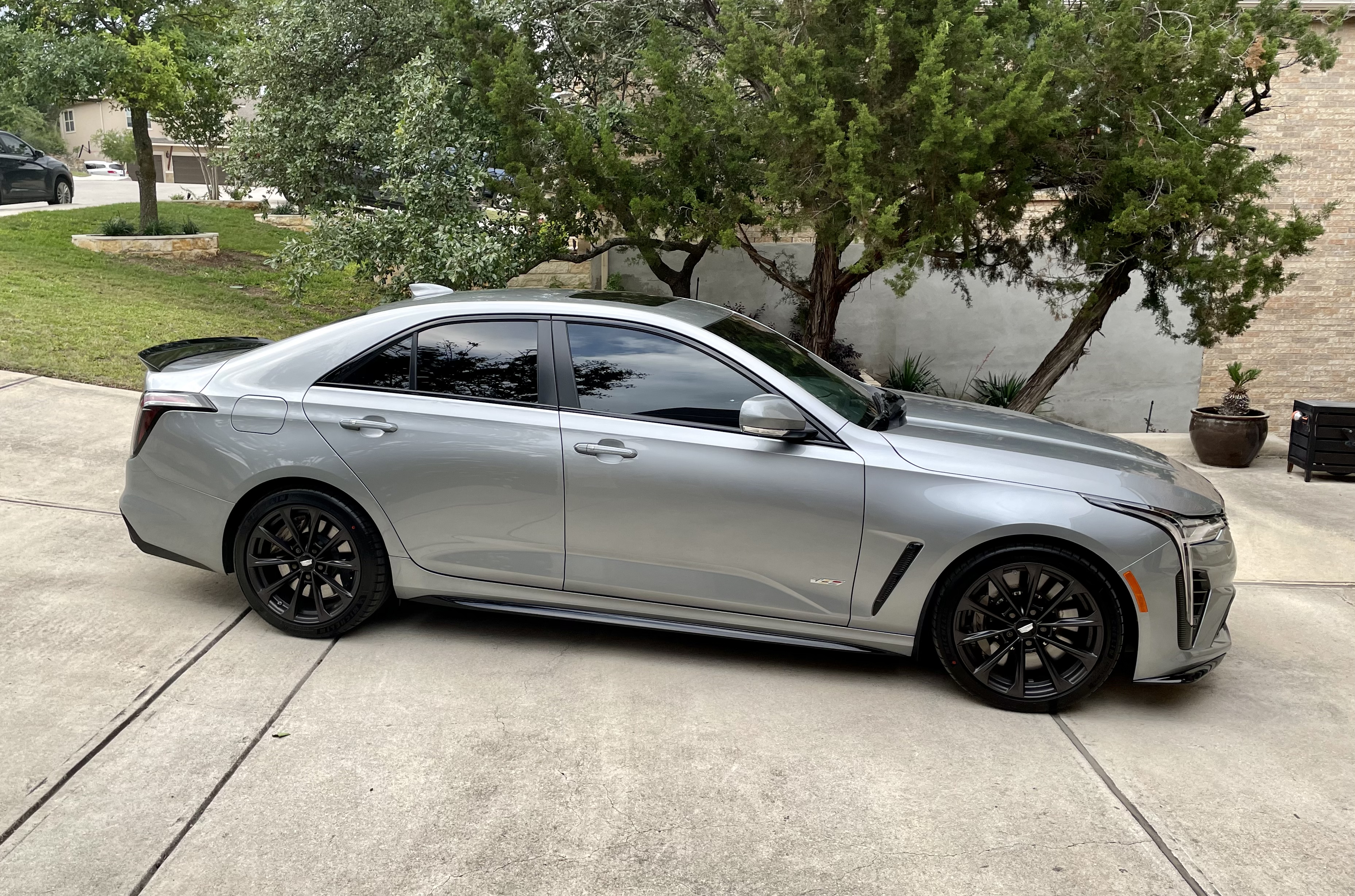

On a side note...pictures do not do this car justice. It looks so much better in person.

Proof of life…
