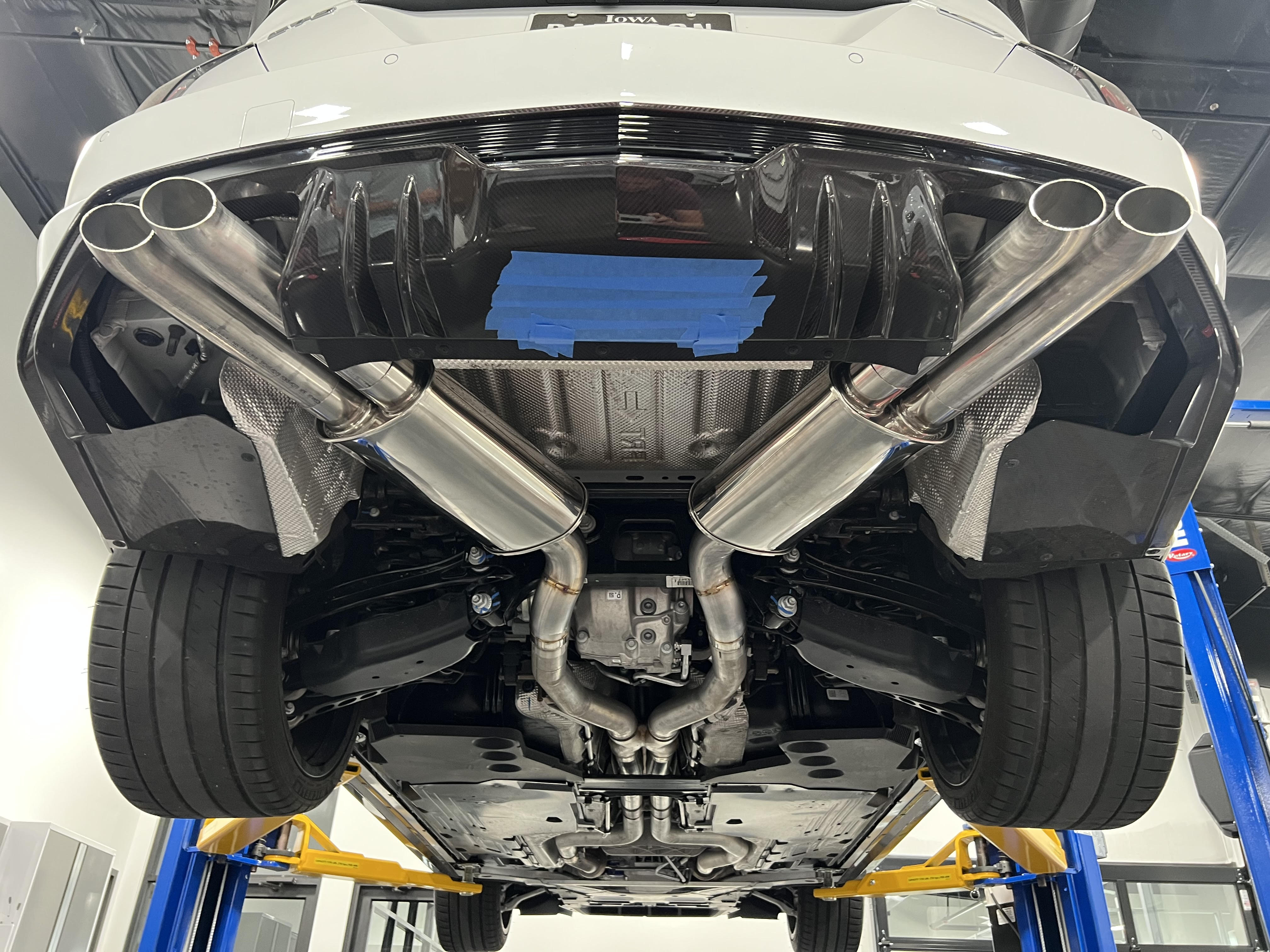

Wanted to share something with you guys. We love our CT-5 BW here at the shop and wanted to give it a bit more life.
We've gone ahead and started work on an exhaust that will be affordable and help waken up the beast.
Some quick points.
1. You will have to cut at a specific spot the rear muffler section off. Directions will be included of course.
WHY? Because making pipes from the front to the back is expensive, not only to produce but to ship. It's also semi pointless due to the OEM diameter of pipe.
2. It will not retain the valve mode that stock has.
WHY? This is too expensive to re-create. V mode still works to activate the bangs and pops, but outside of V mode you will still have increased sound just no bangs and pops.
3. Going back to stock (if you sell or trade in) will be as easy as putting the stock muffler back in and then using an included clamp section to join it back together.
4. Will be quad round tips that exit straight out the rear. Available in Carbon Fiber, Polished, or Burnt Stainless.
5. System will be mostly slip fit. Doing this allows you to not remove the rear bumper to install. Space is TIGHT for getting around some heat shields. Also allows for easy adjustments.
Any a quick pic below. Ignore the straight pipes which were used to just move the hot gas past the bumper for sound testing.

Good try but...
Not integrating the stock valves are a huge turn off for me. I'd like to be able to tone down the exhaust note the same way the exhaust is providing. I'm sure prospective customers will feel the same.
The tips look hideous and not representative of a $100k vehicle. I'm all for function, but put a little more thought on the form. This setup looks terrible and is not in any way representative of a vehicle like this.
I'd love to be a test mule or a buyer but the end product needs to be seriously polished before i'd even consider something like this. Integrate the stock tips or come up with something stylish.

^^^bro, this is not the finished product. They already listed the tip options and I didn't see "mandrel bent finished by sawzall" as one of the options. :)
With that said, I personally think the OEM exhaust sounds really good, and the ability to adjust the "volume" is awesome.

Reading isn’t your strong point is it?

This seems like a pretty 'brute force' approach to changing the exhaust sound.
I don't imagine too many people with $100k 'exotic' sedans are excited to basically sawzall off their multi-functional exhaust and replace it with a less capable component. Sure, the sound is louder, but I just don't see the trade of losing the electronic valves being worth it. Maybe some people would be interested, but I would hope this exhaust would be priced at a point that is representative of the actual engineering involved (read: low) and not simply a marked up profit grab, just to be in line with the sticker price of the car.
I have no idea what the internals of the current muffler looks like, but my guess would be there is a potential to split one open, remove baffling and/or re-route gas flow to gain more sound and then weld it back up. That's a service I would be much more interested in than a set of glamorized straight pipes that require irreversible modifications to the car. Not to mention, I'd be willing to pay considerably more for an elegant solution than something that seems more akin to a mod done on a 2003 F-150.

We understand this isn't for everyone but offers those who want more an option.
We won't see anyone really make anything for this car due to its low production volume so this may end up being the only option ever. We shall see.
As far as it not being reversible, that's not true. You can put back in your stock system and have it welded back to where the joint was created by any local exhaust shop when you are ready to sell or etc. Or you can use the included clamps to put the stock system back on.
As far as not having valves. The engineering time, fabrication time, and etc are just not worth the squeeze. You're going to end up with a system that's 5-6K easy. And maybe move 5 of them.
Granted probably only 10's of these will also be sold but it's much easier to make. Which still isn't that easy. Room is TIGHT back there. We're using several very tight u-bends to get the tips out and in the right spot. It's not as easy as some would think to make it work.
Video of some sounds. We threw tips on it, for the Dyno. They stick out further than they will when production is done. That's currently being finished. Should have some nice finished shots in a week or so. This is just a side project for us and if it doesn't work out for a lot of people that's fine. But for the few of us who want more sound it's a great option. The stock system is way to quiet for how cool of a car this truly is.
