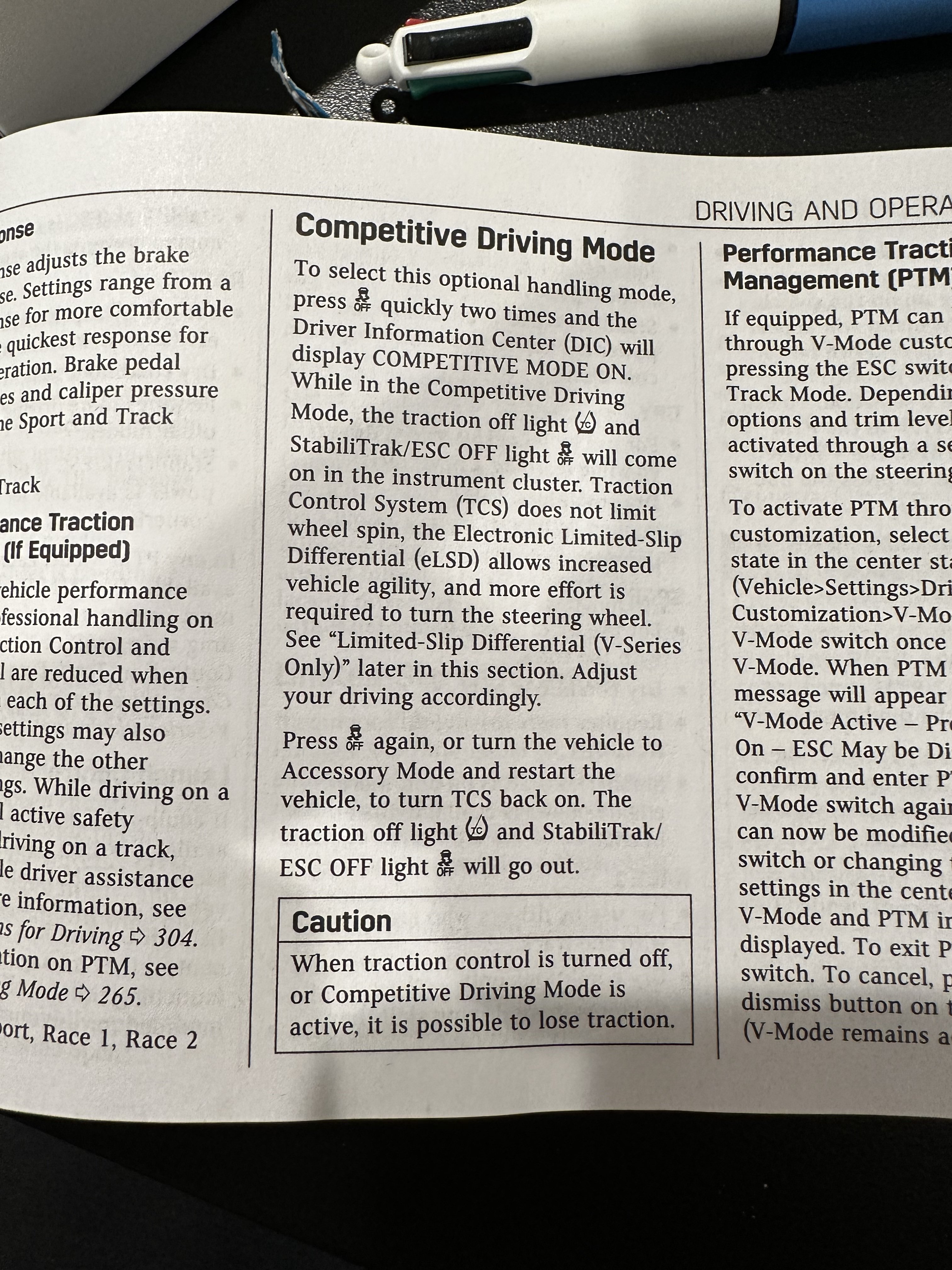

What is the order of operations for getting “competitive driving mode” to show up on the dash?
When i press tc button twice i get both lights to come on but it never says the mode is enabled or anything.
Thanks

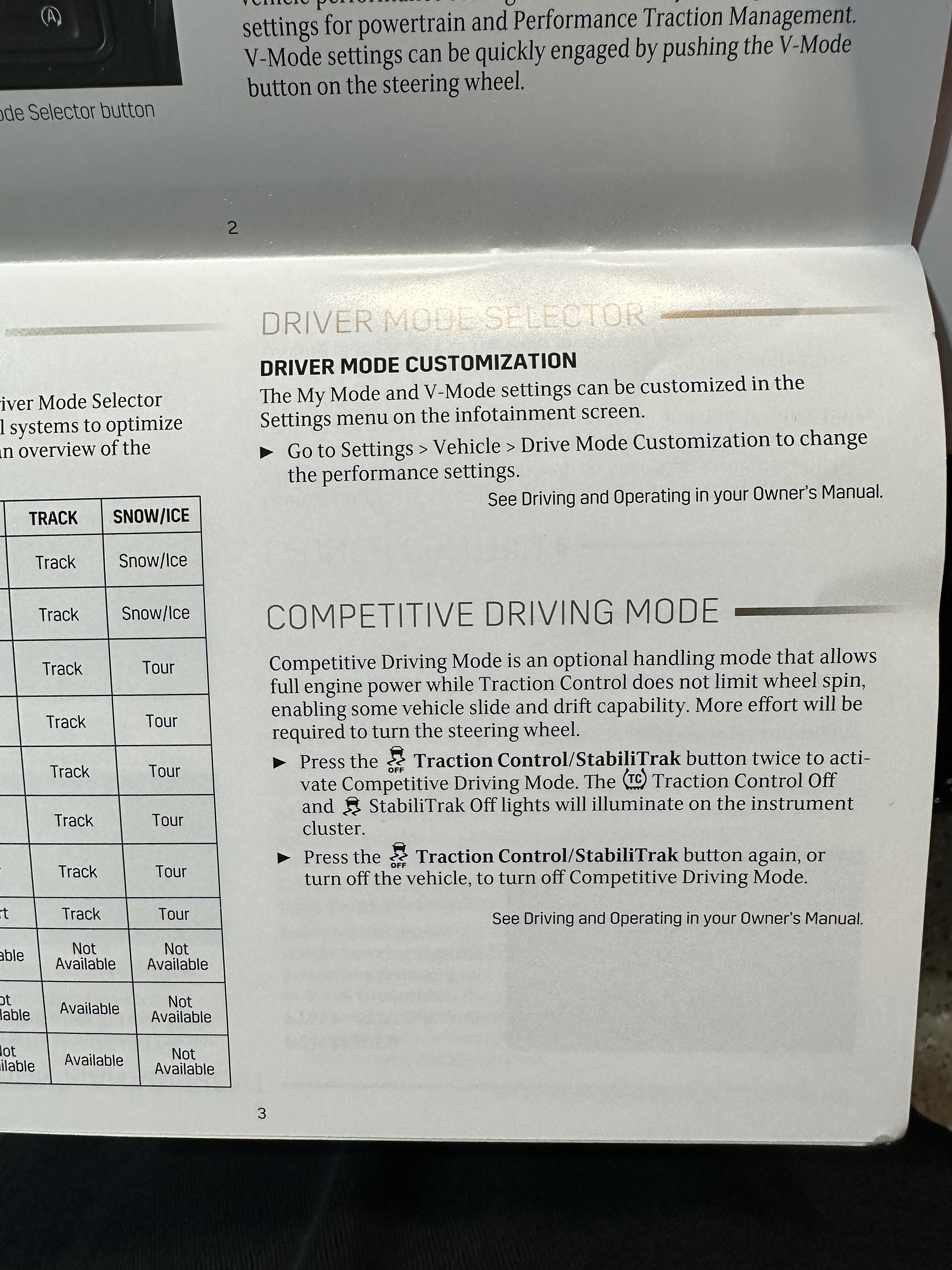

Do the Blackwings have that? I thought that was only a feature on cars without PTM.
Im not sure exactly. Heres some more info from different pamphlet.

^Yes. According to the quick guide it is only accessible when in Sport mode.
I have not tried it, but my take from the guide is that it is effectively a bespoke PTM setting (or heck maybe just on Race 1) to pair with Sport mode.
Edit: what Safridi just posted is the guide I was referring to, but when showing the whole page you can see what I mean about sport.

Yea i think ur right. I think if its a non bw car then it will display “competitive driving mode” and in bw cars if your in sport/track mode then only the two light will go on when pressed twice.

I got my 4BW into it by selecting Sport Mode then pressing TC Off twice. The timing between button presses is notoriously tricky.
P.S. I just checked my C7 Z06 owner's manual. The manual states Competitive Driving Mode is available in Sport and Track Mode for non-PTM cars and Sport Mode only for PTM cars.
