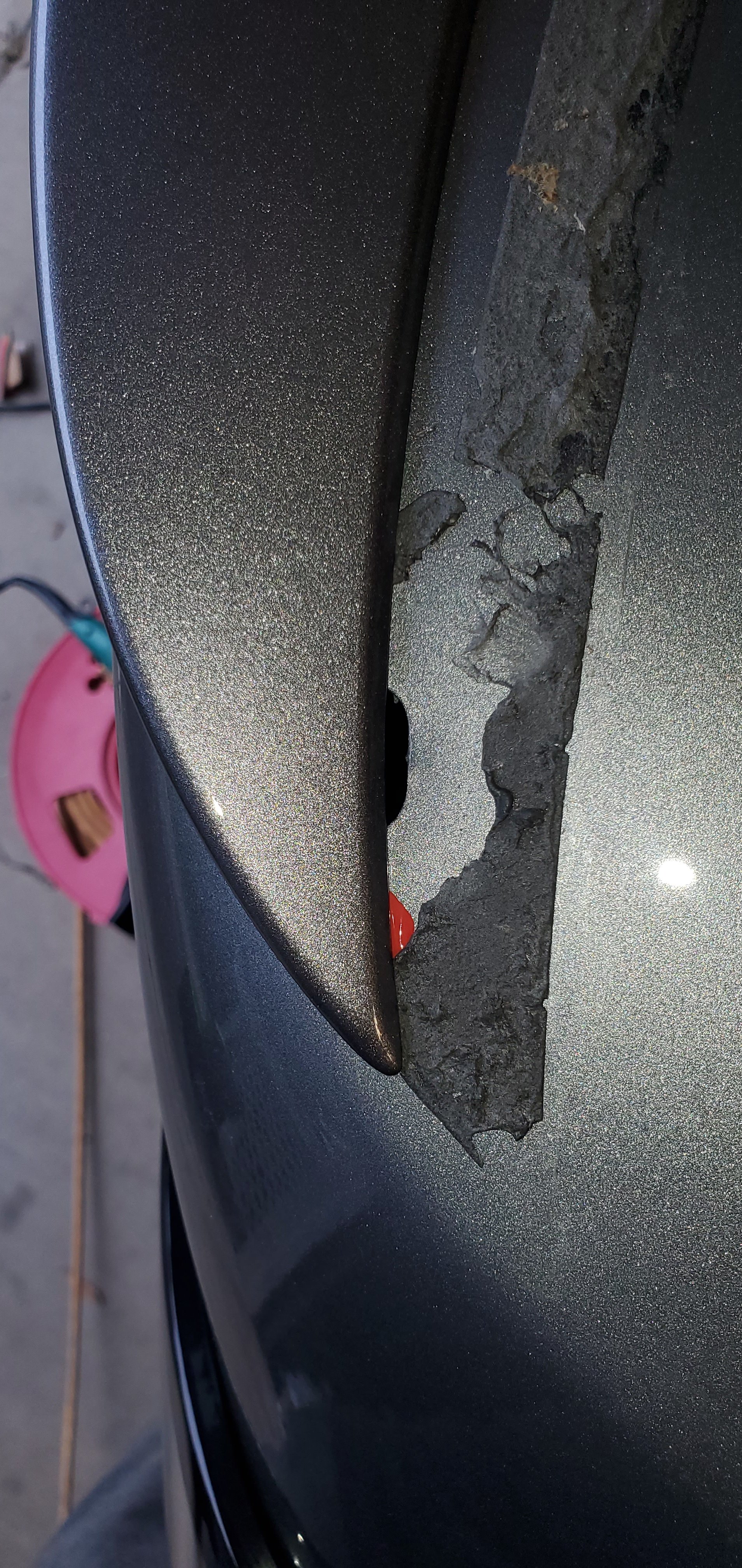

Well, Since I have the base spoiler, non-CF, it should be the same spoiler as the optional one on the base CT5. Not sure if the CT5-V spoiler is any different from that one. The link I posted is a spoiler "designed" or at least marketed for the base CT5. I know the BW CF spoiler has extra mounting locations but with my base spoiler, I shouldn't have the additional holes on my trunk lid for the BW CF spoiler. I like the look of the duckbill version I posted but upon closer inspection of the poor quality pics, it seems that spoiler is almost too generic and not fit good enough to the car. It seems to sit too far forward on the trunk and not way back on the edge, plus from looking at the pics you can tell how wavy the top surface is, its horrible. The same one seems to sell on ebay for like 500+200 shipping from china, or 100-200 total shipped from cali. Ultimately, I guess I'll wait around for a larger spoiler for the 5, thats not the BW version and has a better build quality. My friend has some of his own design CF parts made for the toyota MR2 market so I'll get in touch with him to see what my options may be. Perhaps if we design a nice duckbill version(not too big) to mount on the base spoiler holes, we would just need to have a small production run made. Its something to think about, but not a priority.

I also have the base (non-carbon) BW spoiler and can 100% confirm that the regular V model spoiler does not fit. I didn't particularly love the BW spoiler look either, but I wanted to go the opposite direction and wanted to put a regular V spoiler on mine to make it more subtle. I went and bought the OEM v spoiler from my dealer and tried to mount it. It was a total fail.
There are 5 holes on the BW spoiler and only 3 holes on the V spoiler. The outer most holes on the BW spoiler are oval shaped and probably 1" x 5/8". They have a big plastic clip that goes into them and then a bolt that passes through that. (Also noteworthy: that plastic clip is a HUUUUGE PITA to remove.) Those huge holes are only partially covered if you put a V spoiler on it because the V spoiler has a smaller footprint.
If the eBay spoiler has the same footprint as the V spoiler, it is not compatible with the BW. Trust me. I learned this the hard way. Just trying to save you a headache.
