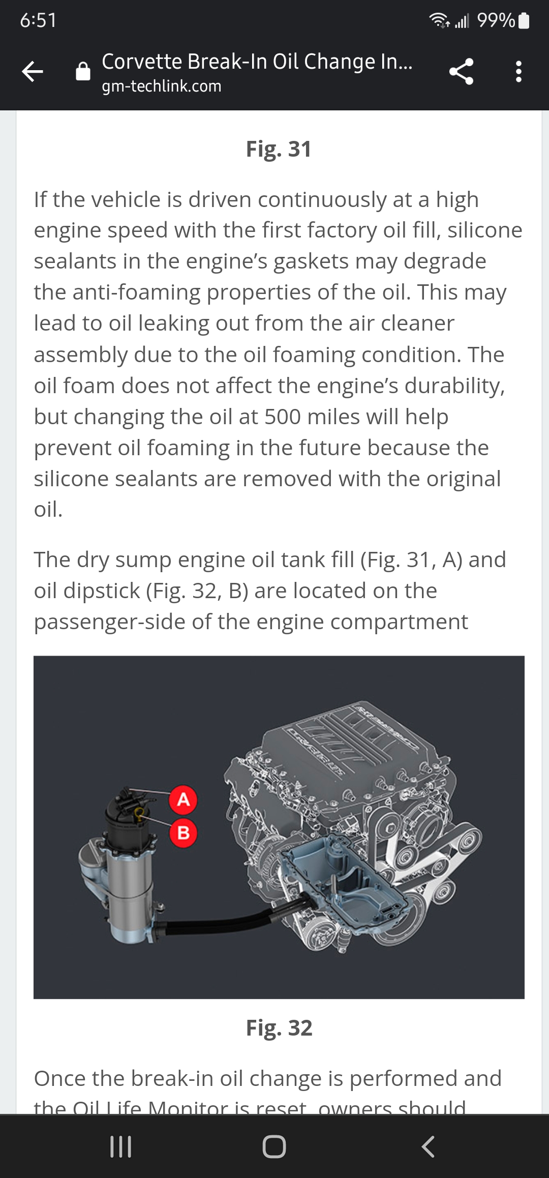

The explanation for the Dry Sump Corvette LT4 engine as to why the oil needs to be changed out at 500 mi.

The calls for early oil changes came because the sealant used in the engine was causing oil foaming when new. I presume GM found another sealant that didn’t have this problem and removed the requirement for a 500 mile oil change. The 1500 mile break in is primarily for the transmission and diff.
They pointed to the dry sump sealant, but the ZL1 is wet sump so why the 500mi oil change? 🤷🏻
