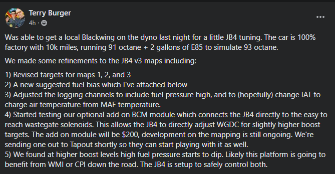

Looks like revised targets for map 1 2 3 along with bcm came out with new firmware update.
I'm not seeing a new FW update. Still the same (74) map that's been out now a few months. Are you seeing the bcm available somewhere?

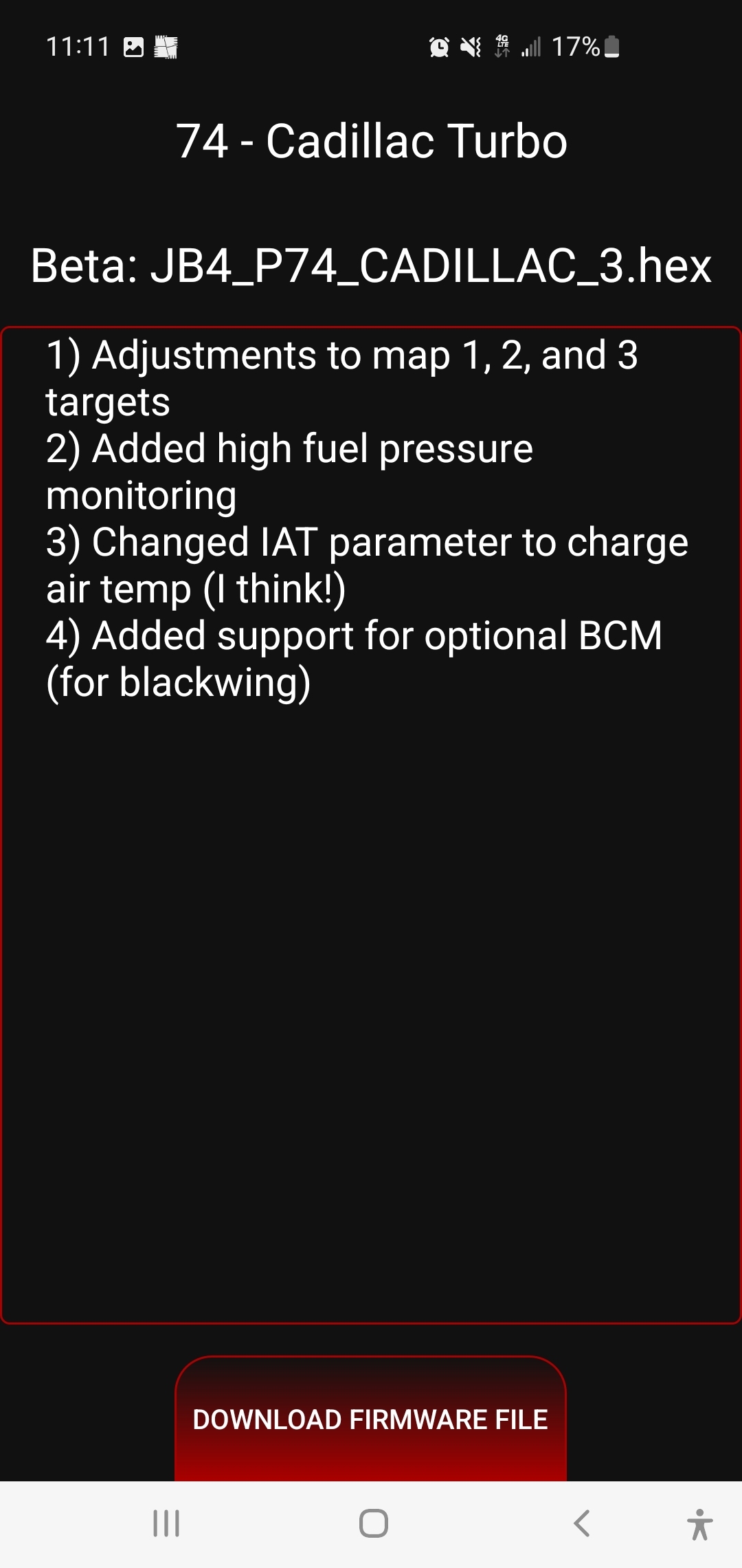

ah yeah. That's the map update from 11/11.

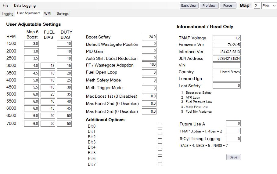

Terry recommends running his fuel bias settings that are posted above with it as we

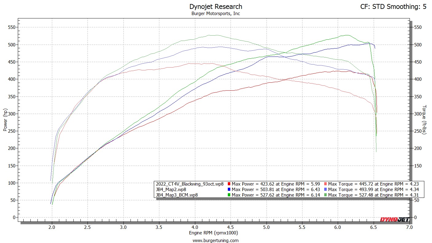

Damn didn't realize it from nov. Have the blue belt installed. I did these fuel bias and wow so much stronger. I didn't change the wastegate adaption since didn't have the bcm module.
Was kinda worried that i was making a paper weight since very little info on jb4 ct4 bw.
Really screams on map3 with e30. Turns out my bw has a drinking problem.
