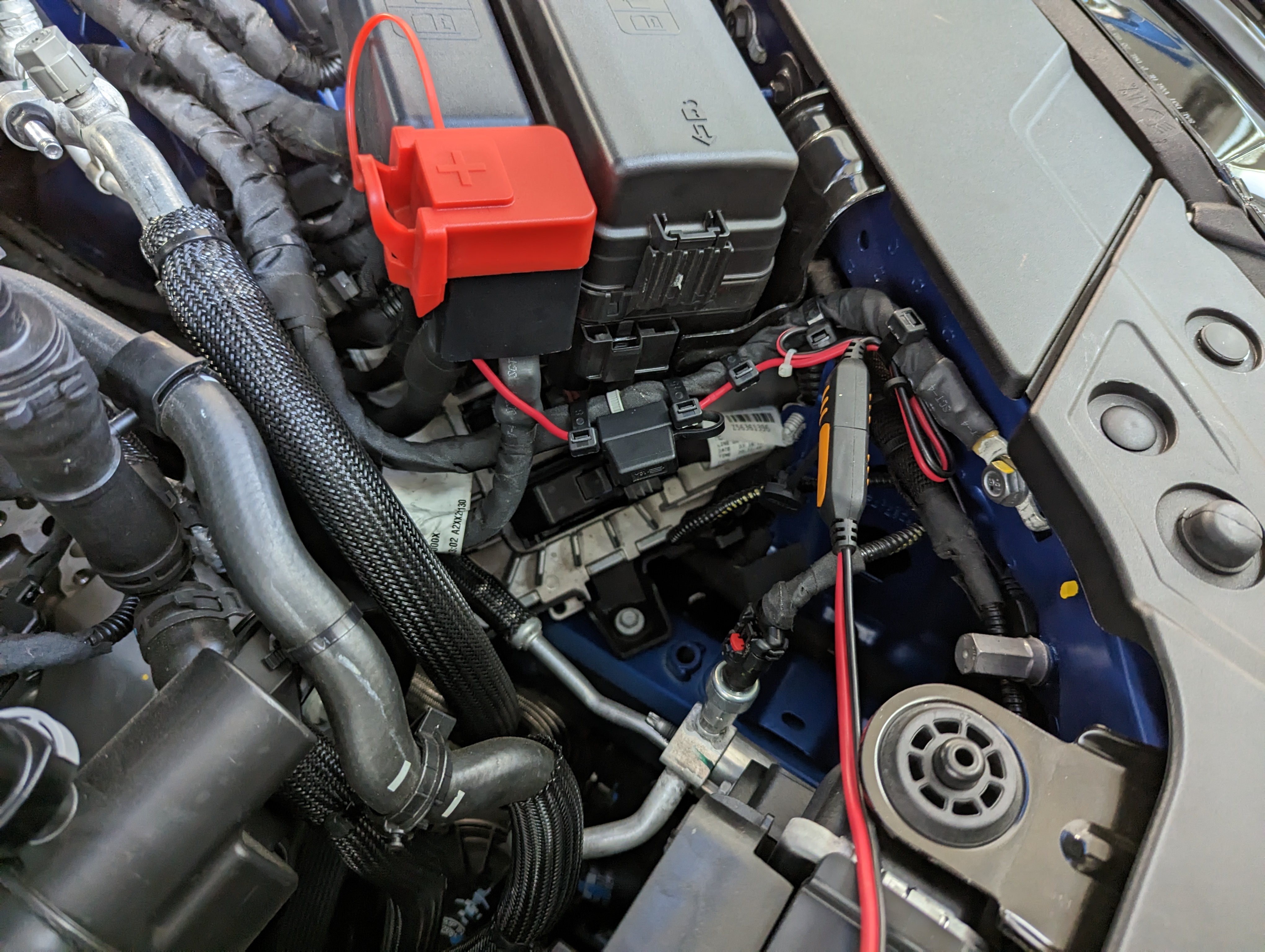

For that exact reason (convenience to outlet location) I have mine mounted under the hood. It shouldn't matter functionally whether it's the jump points, battery, or cigarette lighter. Also, with AGM batteries, you are supposed to use the winter setting which is slightly higher voltage. 14.7V vs 14.4V.

For that exact reason (convenience to outlet location) I have mine mounted under the hood. It shouldn't matter functionally whether it's the jump points, battery, or cigarette lighter. Also, with AGM batteries, you are supposed to use the winter setting which is slightly higher voltage. 14.7V vs 14.4V.View attachment 13948
Can you share details on how you wired this up?

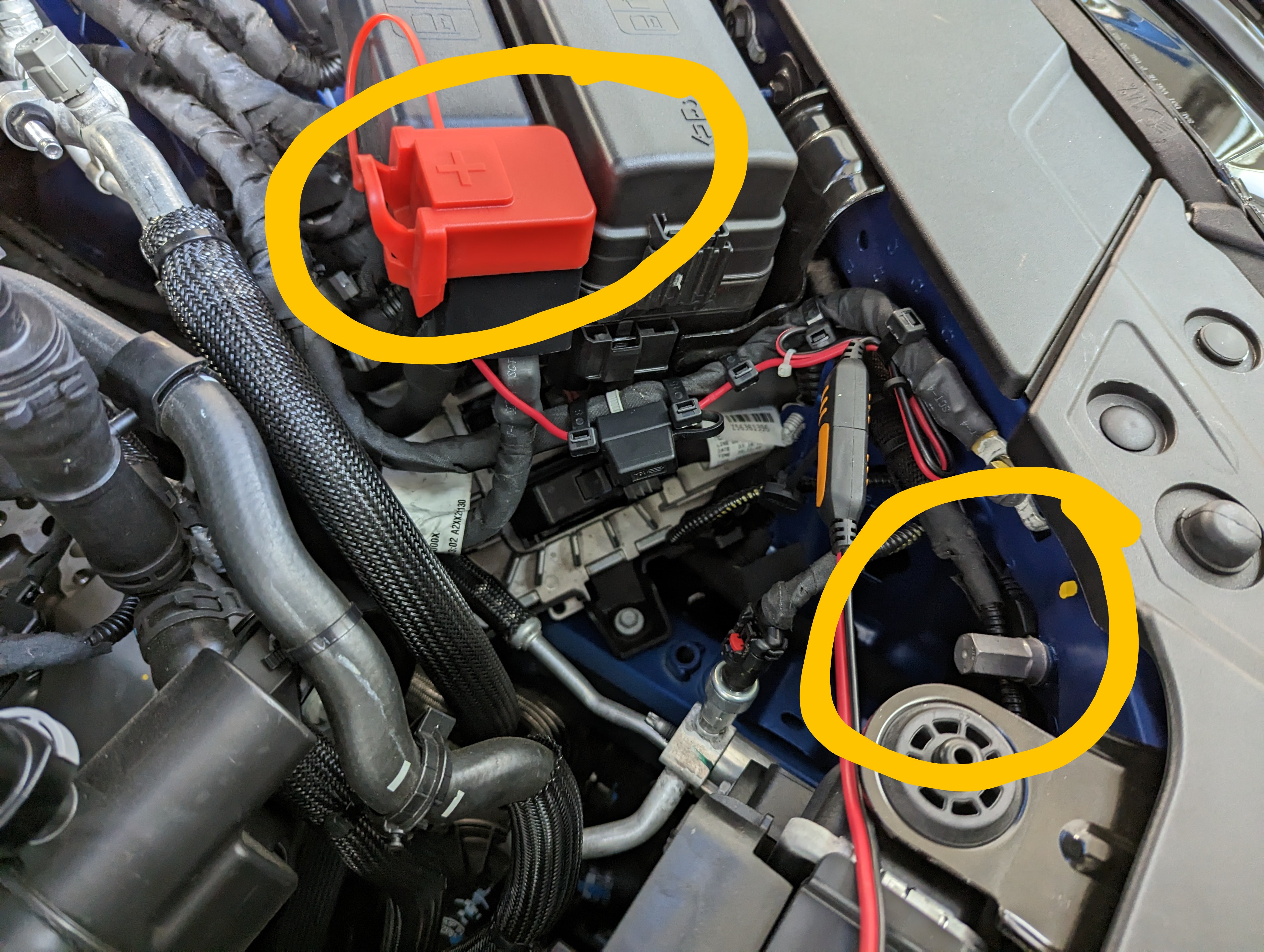

The red lead goes under the plastic cap to a post that's pretty obvious when you get in there. Take nut off, put eyelet lead on, put nut back on. The black lead goes to the grounding post circles. It comes right off. I used zip ties to tidy it up.View attachment 13959
Thanks. I had that setup on my V2, but wasn't sure how to get behind that grounding post. Did the standard pigtail work or did you have to buy the one with the larger eyelets?
