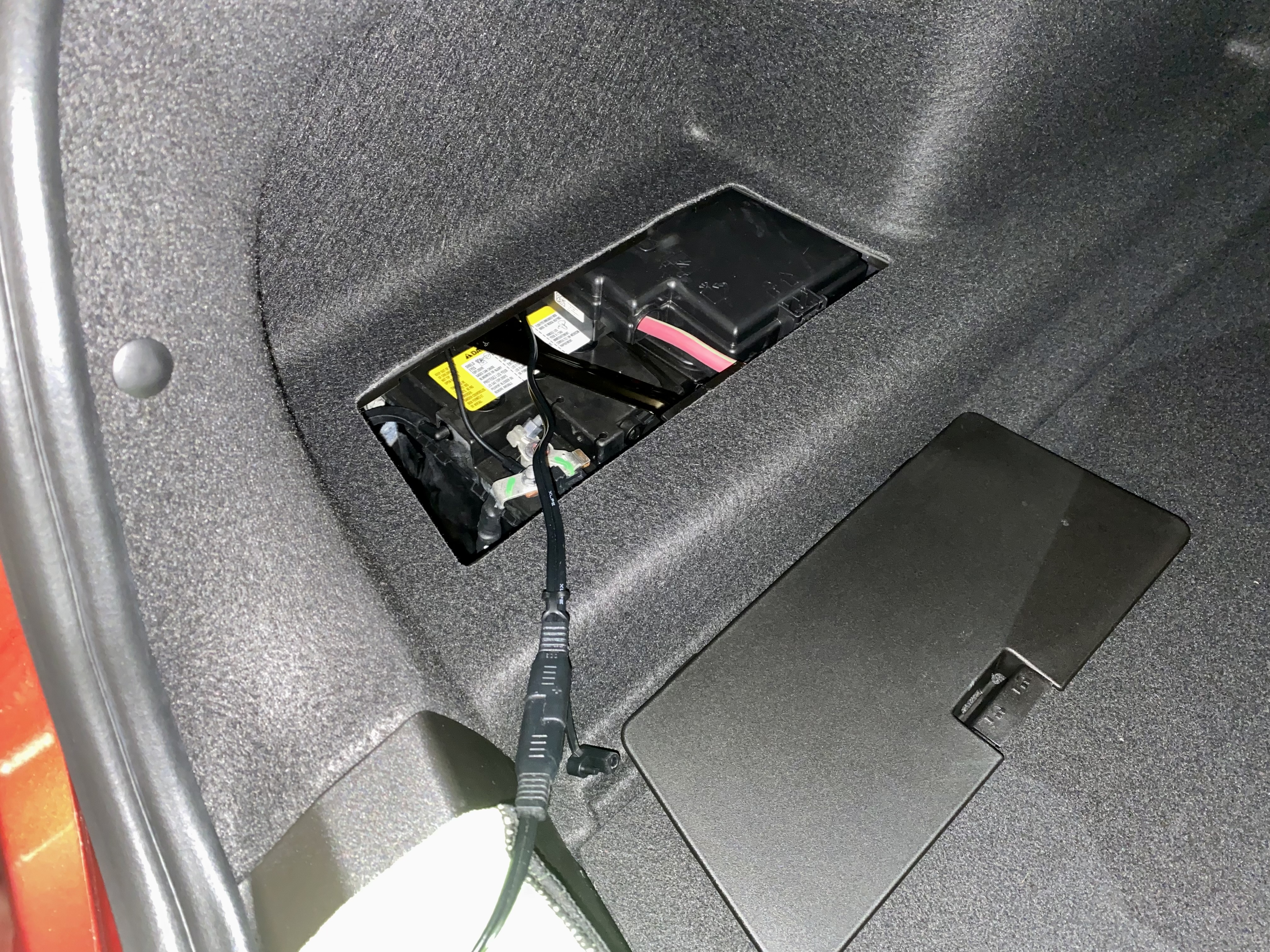

The OEM chargers between Corvettes (at least C7) and 4BW have different ends and I don't know how feasible it is to swap them. The 4BW has points for the clamps under the hood, front driver-side.

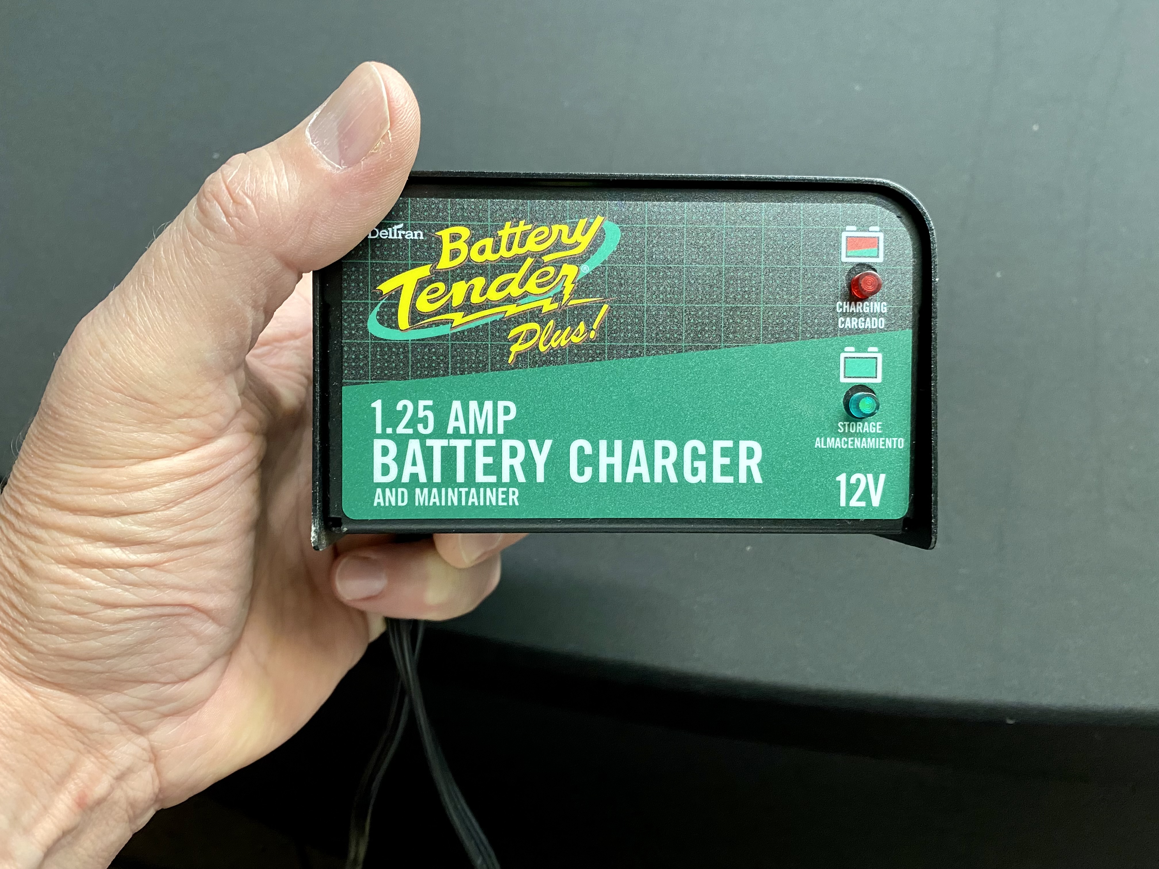

Dealer told me not to use the jump points. Called Deltran battery tender company. They told to check which tender I had(1.25Amp) said that was not enough amp for newer cars with more electronics. Recommended 3,4,5 amp tender. They said it should work through the lighter, however they then told me to hook it up, if the red light came on and was steady you could use the cigarette outlet. If the red light blinks you can't use the tender. Hooked up as they said and the light was flashing not steady and cigarette port should not be used. How hard is it to get to the positive post on the battery in that small opening? Negative post is easy how do you get to the postive post. Mine has electronics over the post, can you make room after loosening the battery hold down?

Mine is directly wired to the battery with a quick disconnect.. (see above pic)
