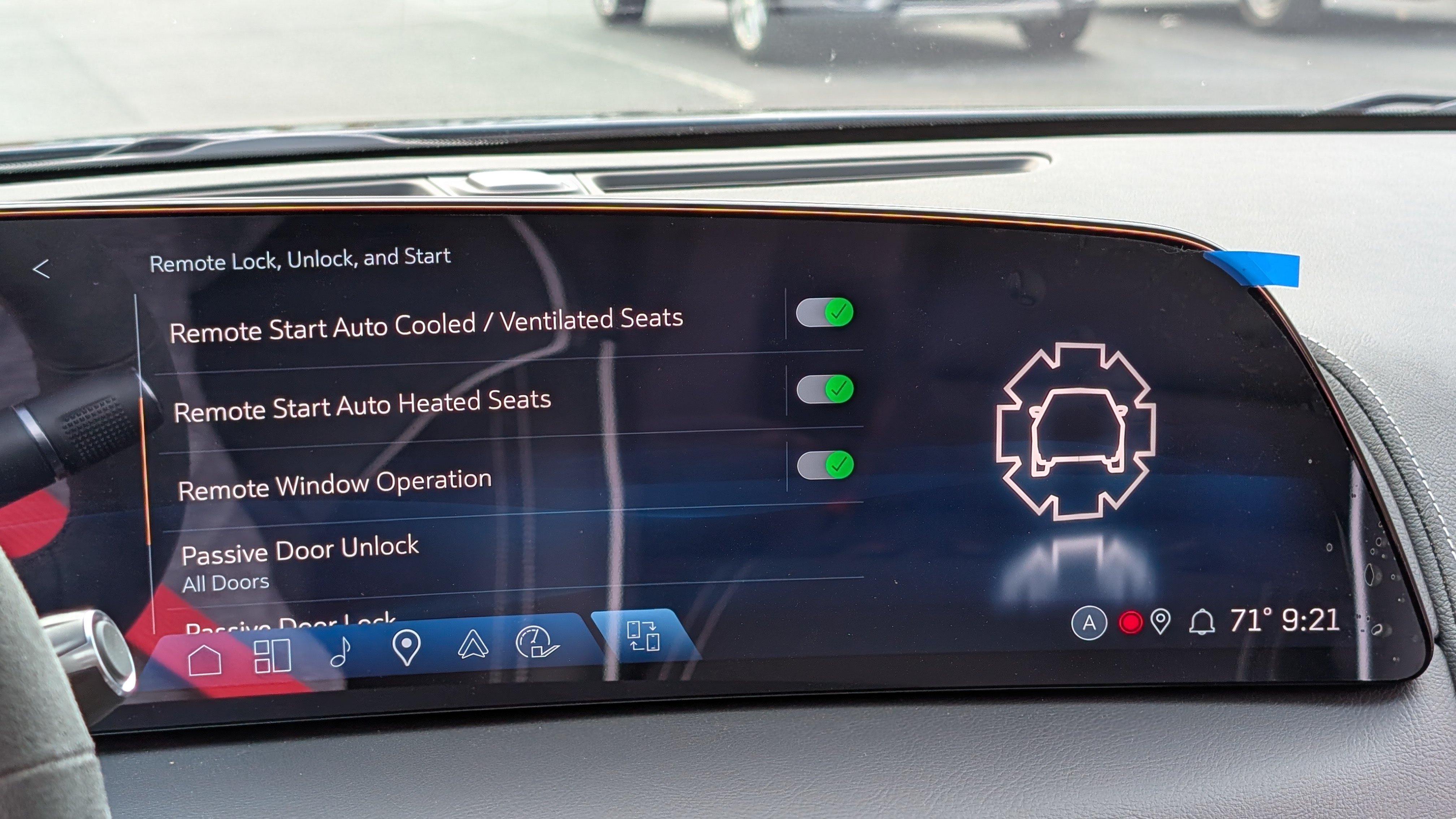

Settings -> vehicle -> remote lock, unlock, and start -> remote window operation
Note: This works in reverse as well. Holding "Lock" on the remote causes all windows to close.

Go to Settings, Vehicle, remote lock, unlock, and start, and then easily select remote window operation. It's right there.
If someone needs a video to figure this out I can also do that for you.
Press the unlock button on the key fob one time, and then push it again and hold it down. The windows will roll down.
Press to lock button on the key fob one time, and then push it down again and hold it down. The windows will roll up.
One long push on the lock or unlock button for up or down. No need to double press. That's how mine works.
