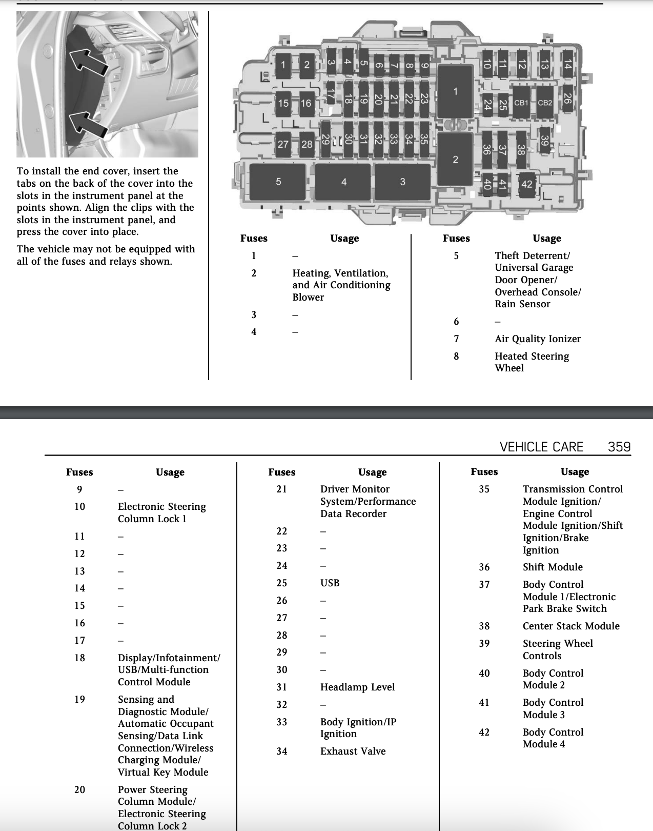

Curious if anyone has tried this on a 4BW yet? Curious if it works the same as the Corvettes and Camaros I have owned. Does it throw a CEL? It looks like it is fuse 34.
This will set codes on the Blackwings.

It looks like you have a 5 so it if is the same as the Camaro ZL1 and Corvette Z06 maybe you can pull Fuse 51 without a CEL? No idea. The 4BW is new to me and look to have a different setup, more fuse blocks, etc.
Good to learn about the fuse. So it's fuse 51 on the 5BW ?
Did you get that diagram from shop manual ?

I found the fuse block diagrams in the regular owner manuals. Not sure on the CEL.

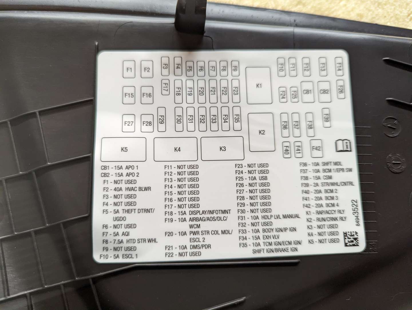

Exhaust Valves on CT5 BW are Fuse 34 in the dash by driver's door.
I just pulled it and went for a very short test drive but did not notice much difference. No CEL.
:( :( :( I thought i might have found a cheap, easy solution to make it louder. I do appreciate learning about this though. If I ever get the exhaust redone, this will let me know how much its closing at other times/RPMs.

Nice. Yeah, it doesn't actually make it louder per se, it just removes the programming they have dialed in to close or partially close the valves at various speeds and RPM. On my ZL1 I would notice a pretty significant drop in exhaust volume when you dip below around 2200rpm. You could hear this little, "hitch" when the valves transition and I found it annoying. Most don't notice it but I preferred the valves wide open all the time at all RPMs and speeds.
The big concern was if you pulled the fuse then would you get annoying drone at highway speeds. I never noticed any difference in the ZL1.
If you drive it a bit more and and then put the fuse back in you may be able to tell the RPM levels where the valves close. You should get a little more exhaust volume at lower RPMs.
Drove it quite a bit tonight. It seemed barely perceptibly louder at highway speeds, but still nowhere close to droning.
And I was wrong - the CEL was hiding behind the steering wheel on the upper right side of the dash. I'll plug it back in tomorrow and reinstall the cover. Hopefully CEL goes out. Dealer will still see the code, but who cares..........
Good news - I can keep the stock valves and likely not have to worry about it making it that much quieter.

Maybe you can clear it with a cheap ODB code reader? If you disconnect the battery for a bit it may reset as well.
I have a code reader, but today the light went out on its own after several ignition cycles. Its all put back together, so hopefully the dealer won't give me a hard time at my first (free) oil change.
