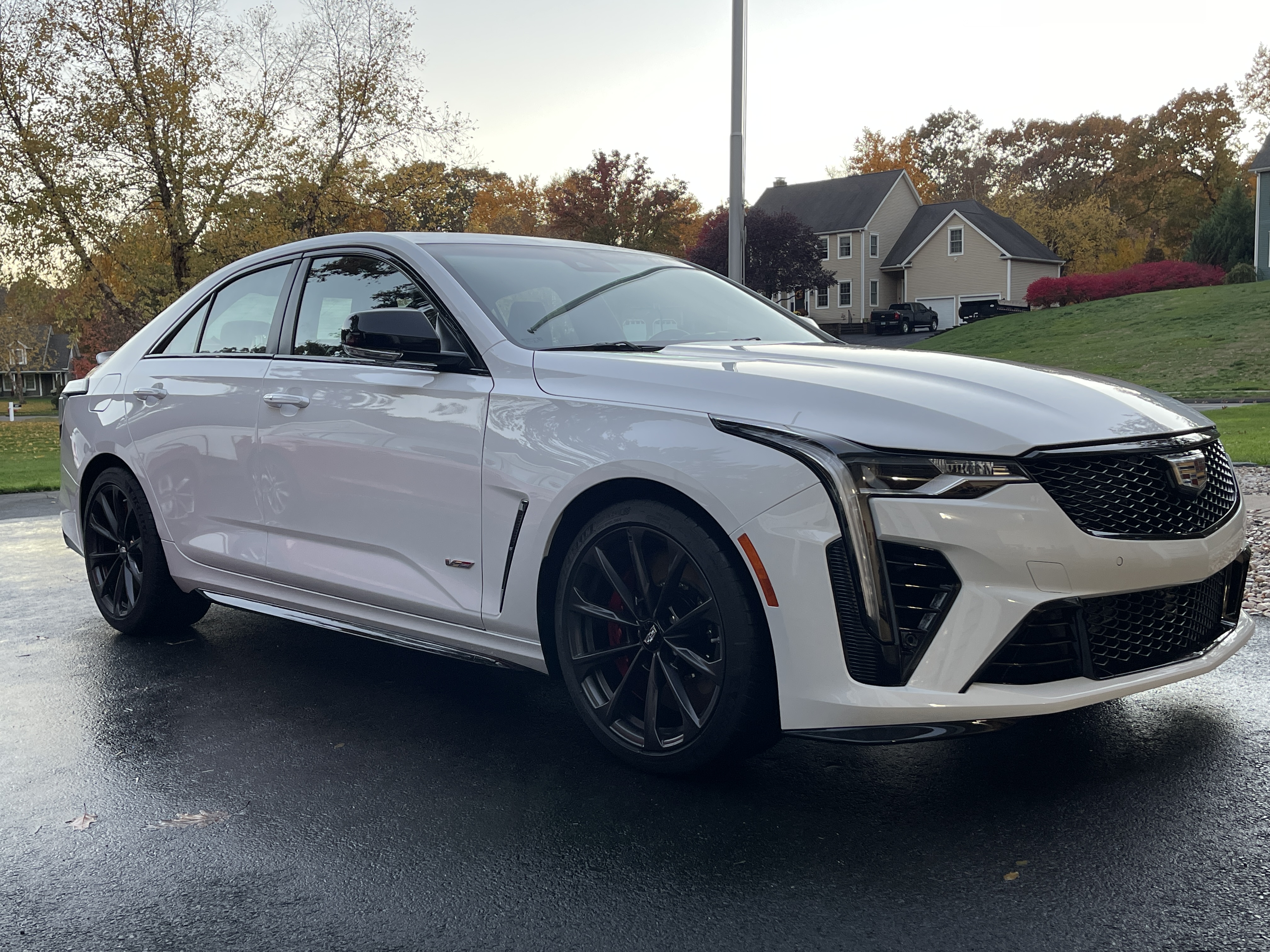

Hey guys, great page, lots of good information.
I wanted to start a thread regarding aftermarket wheels, specs, pics etc. This help others when trying to select wheels for their car. Be sure to post all the specs, and pics help too.
CT4 or CT5
Wheel Brand
Front & Rear Size & Offset
Any Spacers Needed?
What Size Tires?
Are You Lowered?
Any Fancy Lugs?
Any interference when turning or over uneven surfaces?

I'd start, but my car is 5 days old and I'm still stock (for now). I'm coming from an Audi S6, and this is my first Cadillac. View attachment 13649
Welcome! I came from an S6 as well but missed my S4 manual so I ordered their love child, a V8, manual Blackwing. 3000 mile later and I love it. Miss some of the touches of the Audi but when slamming gears, none of that matters.

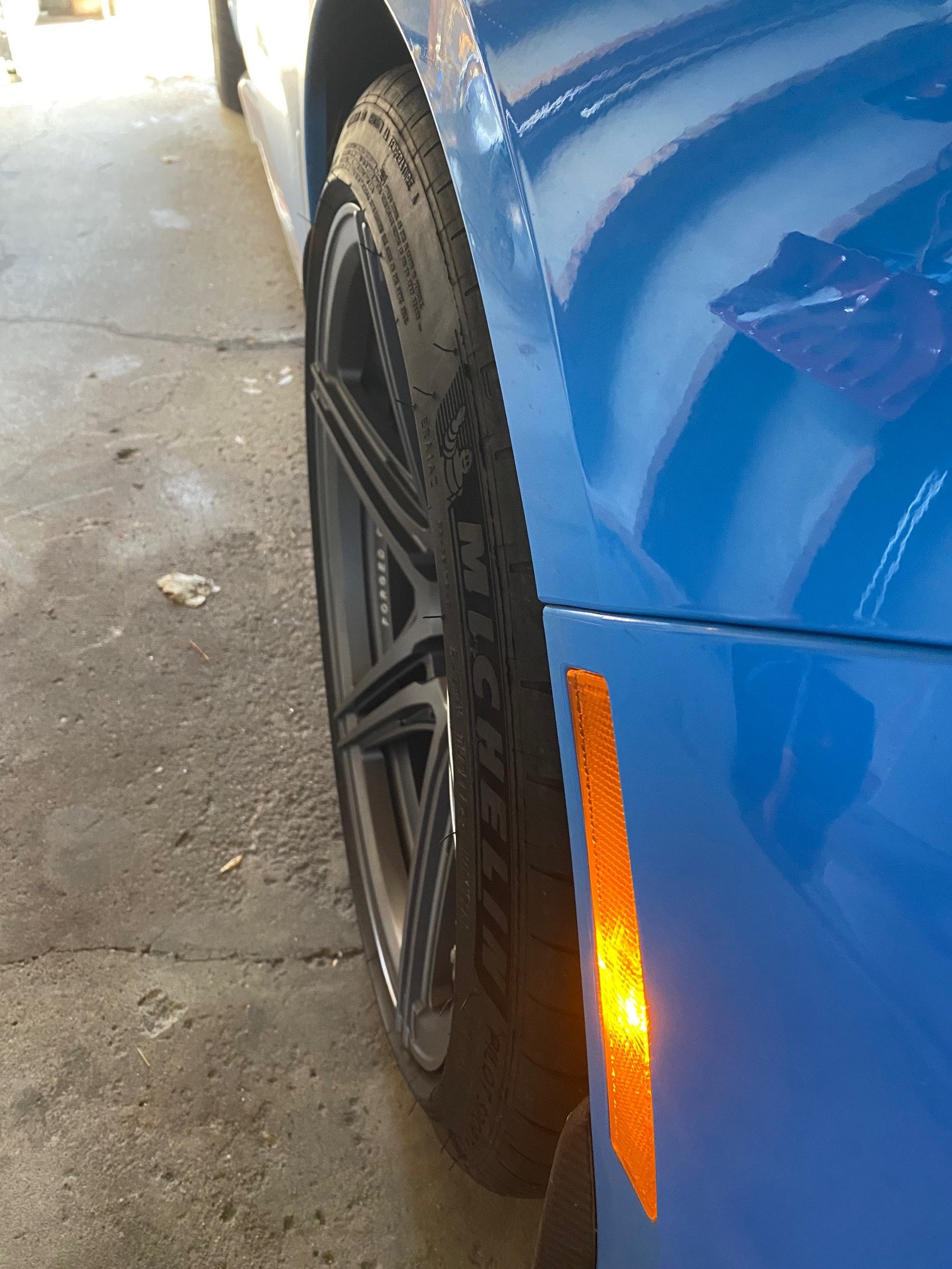

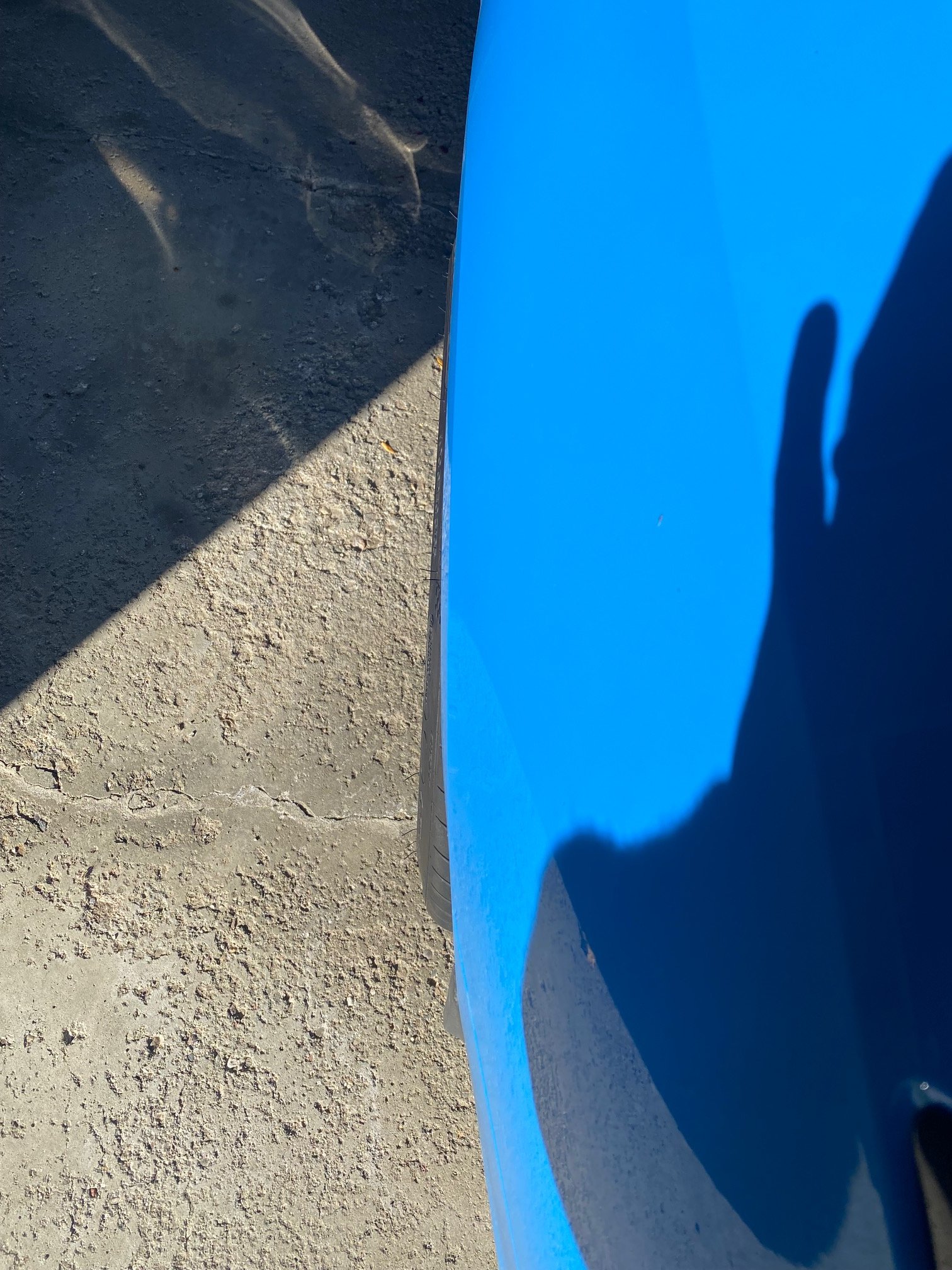

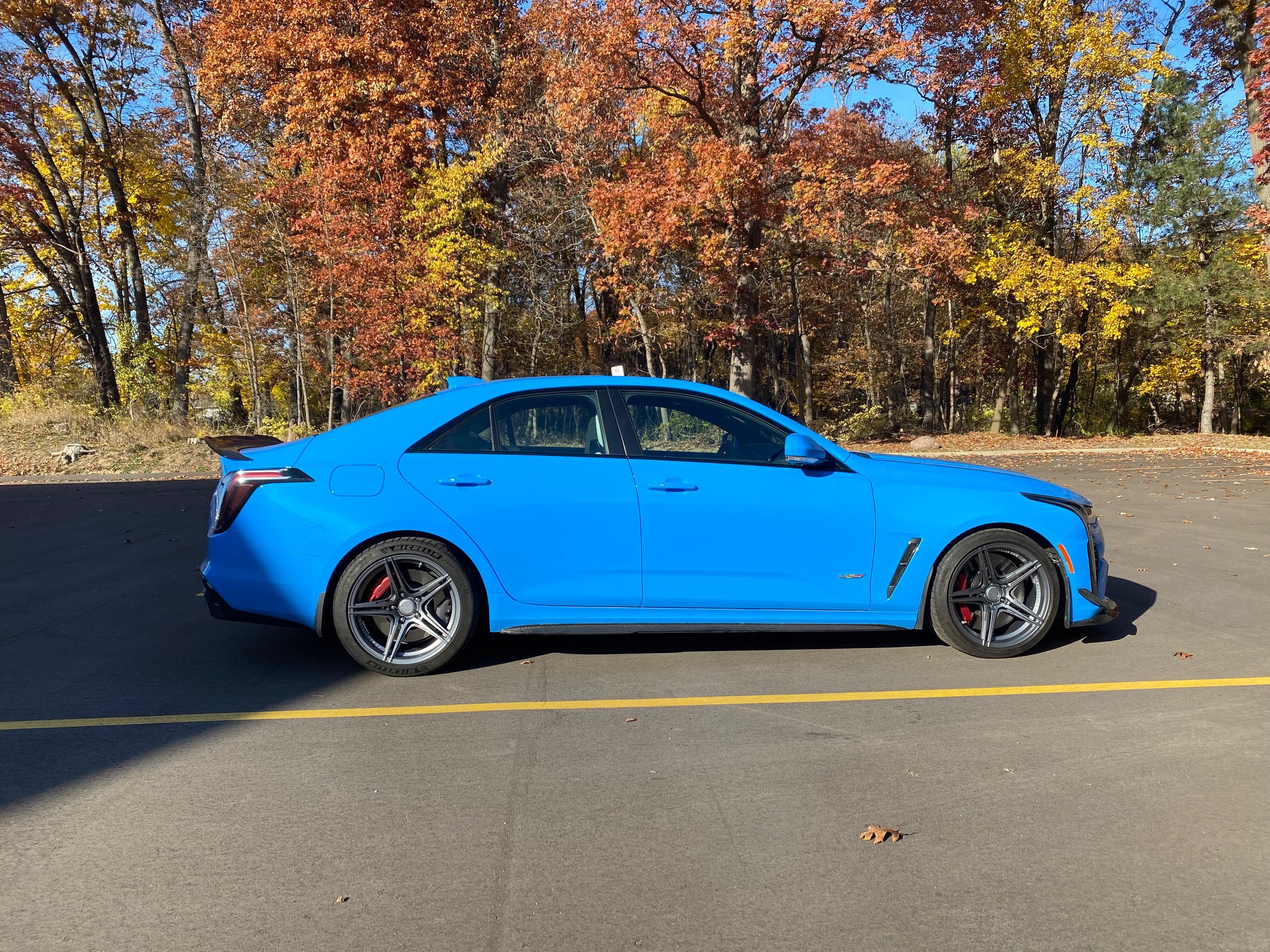

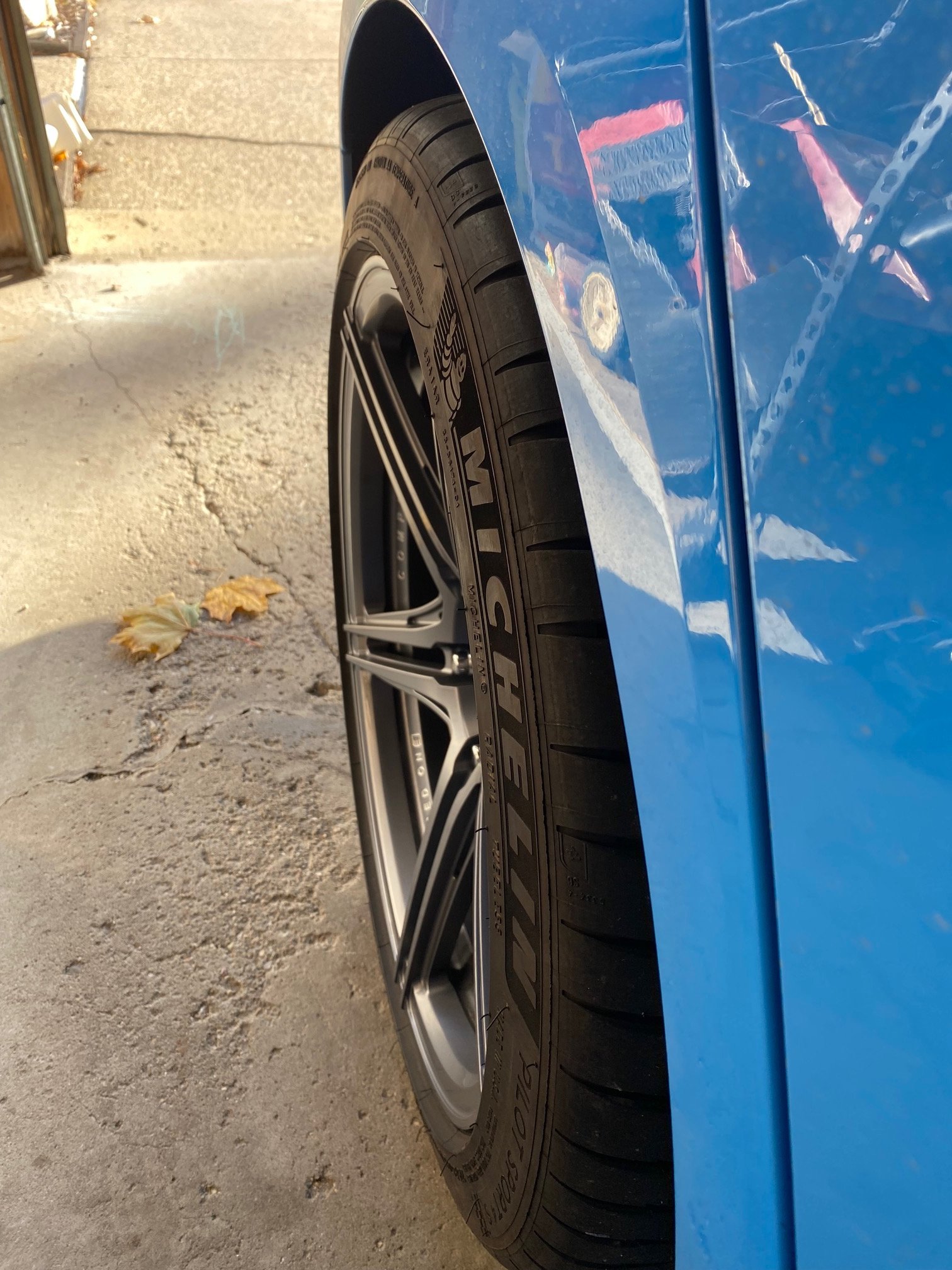

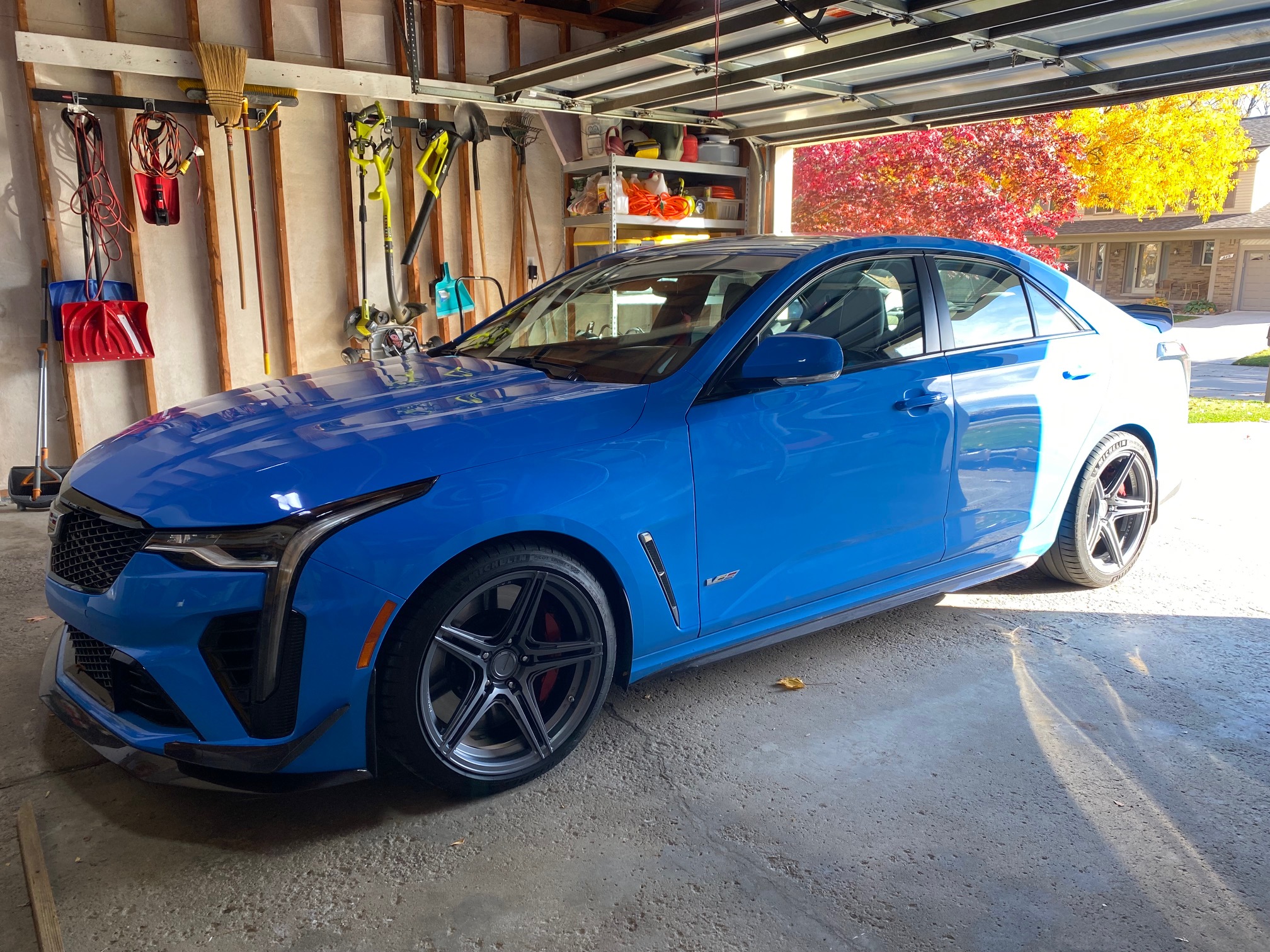

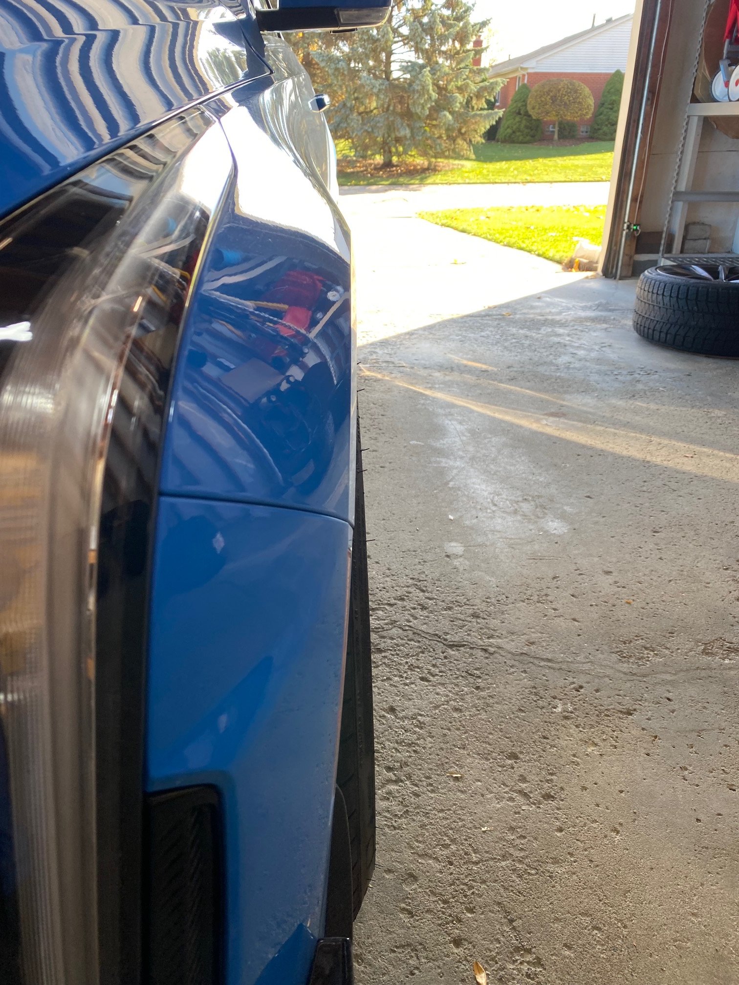

I'll add something.
2022 CT4 BW. I originally bought these FF05 wheels with Blizzak snow tires but after seeing the wheels I liked them so much I swapped summer tires onto these, and Blizzaks on the OEM wheels.
Wheels: Forged One Competition FF05.
18x9.5 +20mm front. Michelin Pilot Sport 4S 255/35/18 front (OEM tires).
18x9.5 +33mm rear. Michelin Pilot Sport 4S 275/35/18 front (OEM tires).
4x hubcentric rings.
No spacers.
Stock suspension.
Used aftermarket lug nuts that came with kit. Unable to use stock GM lug nuts.
Purchased the FF05 wheels from Tire Rack; it notes the rear are "aggressive fitment and may require fender modification". I can confirm they fit on stock suspension, clear all brake calipers, no rubbing on front lock-to-lock, and no rubbing in the rear.
Cheers,
Christopher

nice! I just ordered these same wheels. The tire rack listing now says aggressive fitment front though…can you confirm you have no issues rubbing or otherwise? Not a cheap setup but hardly any options out there…cheers

Yes I can confirm the FF05 wheels clear all brake calipers easily. I am running the original spec summer tires that are 255 front and 275 rear on these FF05 wheels. I have absolutely no rubbing issues front or rear. I’ve been driving on these wheels and tires set up for about 300 miles without any issue. Feel free to message me directly if you have any other questions or need some pictures.

Maybe it's just me, but I'd be happy to take a look at some pictures if you'd care to post them here!

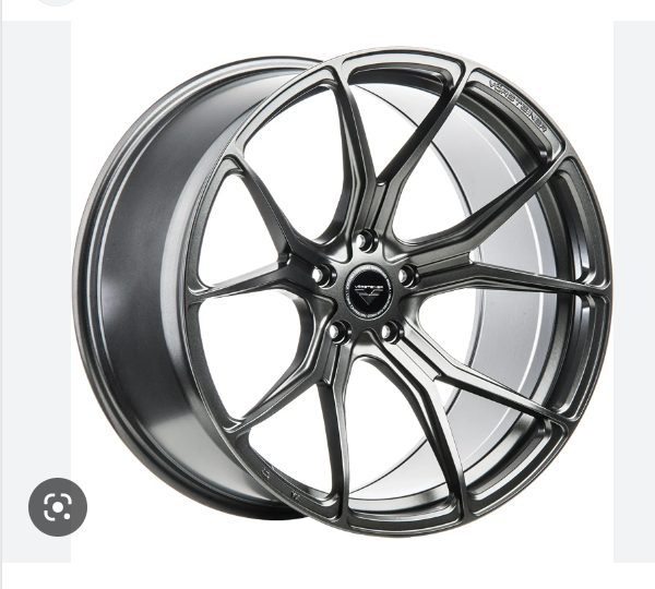

I'm thinking about these... BUT, I want to go with 19's on my 4BW, and what are thoughts on a 35 sidewall on 19, on the 4? Its tight in there... But Here's what I wanna do;
Front: 19x9 21mm offset, 265/30/19... Or 255/35/19
Rear: 19x10 40mm offset, 285/30/19...Or 275/35/19
Thoughts on this setup?

Doing a little of research, you could fun a 265/30/19 on that 19x9 +21 wheel; it'll given you 7mm more clearance inside the fender, and poke out 7mm more curb side. This is doable, my current wheels poke out 8mm front with no clearance issues.
Regarding the rear 285/30/19 on a 19x10+40 wheel, you're going to be poking curb side about 14mm more, which is doable, but having a 285 series tire versus 275, I would be concerned about possible rubbing. I have wheel/tire setup that is 15mm extended in the rear and it's very flush with the venders, not sure I would go more.
But obviously it all depends on the wheel/tire setup, stretch of tires, etc. May require rear fender modification to prevent rubbing would be my concern.

They have the 19x10's in a +45 offset, would that fit better in the rear? How much poke over stock would that make it?
