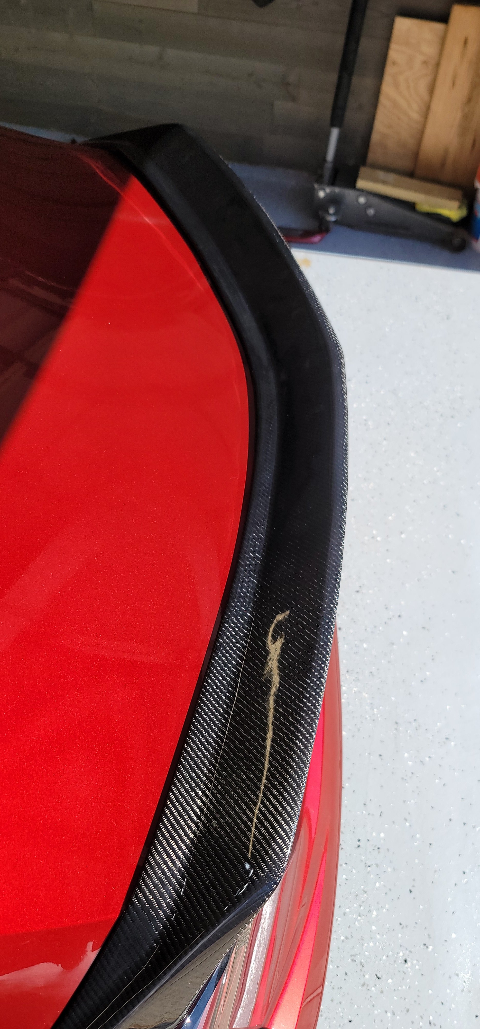

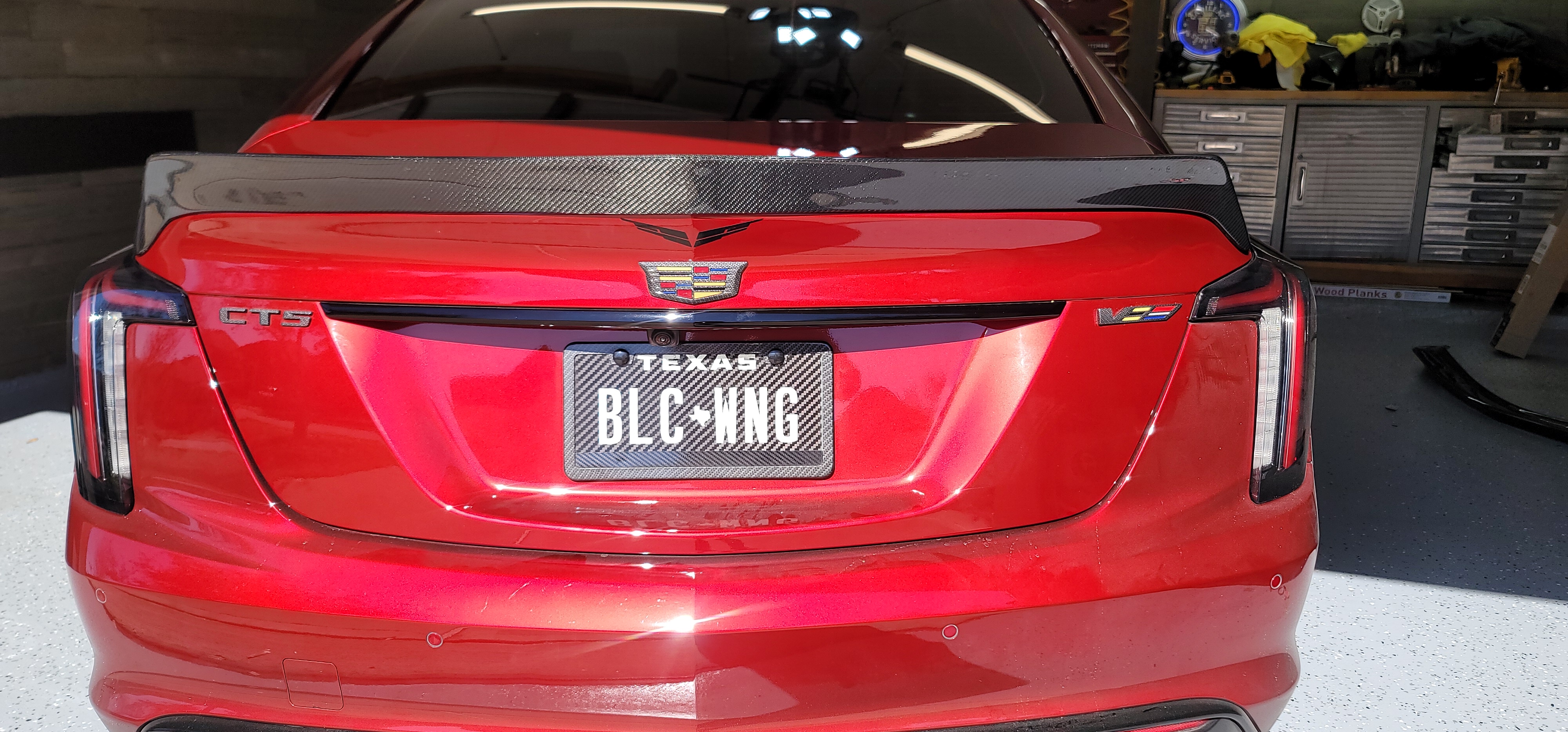

Thought i would share. Originally had stuck the aftermarket carbon spoiler on top of the original shorty one. Fyi original is only double stuck taped down. Looks and fits much better. Also found an extra one on ebay so i have an extra in Houston area if anyone wants it. Would prefer not to ship $200.

@FishinV I'm in the boat of having to drop CF to get a car (it worked) and am looking at aftermarket options. I would like something larger on the rear other than the standard one that matches the one on the V. Can you share more about how you mounted the spoiler? Is it taped over the taped-on small factory one? Did you DIY? I like the one from Savage, but they confirmed it is taped on.... which just doesn't feel right on a car with these capabilities.
So originally i had it taped on top of the small factory spoiler and drilled a couple screws from the bottom (opened up the trunk liner for access).
Now i took off the original small spoiler and installed directly on the trunk lid. There are several holes in the trunk lid, just have to cover them with double sided tape and i generously used a lot of double sided tape to stick it down. Now it fits perfectly and lines up and looks much better than before i removed the original spoiler. Yes i did it myself.
I also put 4 small screws in it through the factory holes with some washers to secure it even better. The spoiler I have is hollow so i only used maybe 1/2 inch long small screws and used a screwdriver instead of a drill to keep from stripping. When i had it on top and screwed down, i saw over 160 mph with no problems.
I was just at Spring mountain a week or so ago and saw the original factory carbon, and the one i have is probably the exact same height as factory but it doesnt have the two small vertical indentions that the factory carbon does. I have had compliments at car shows and most people think it came like that from the factory. (for a $280 spoiler LOL)
