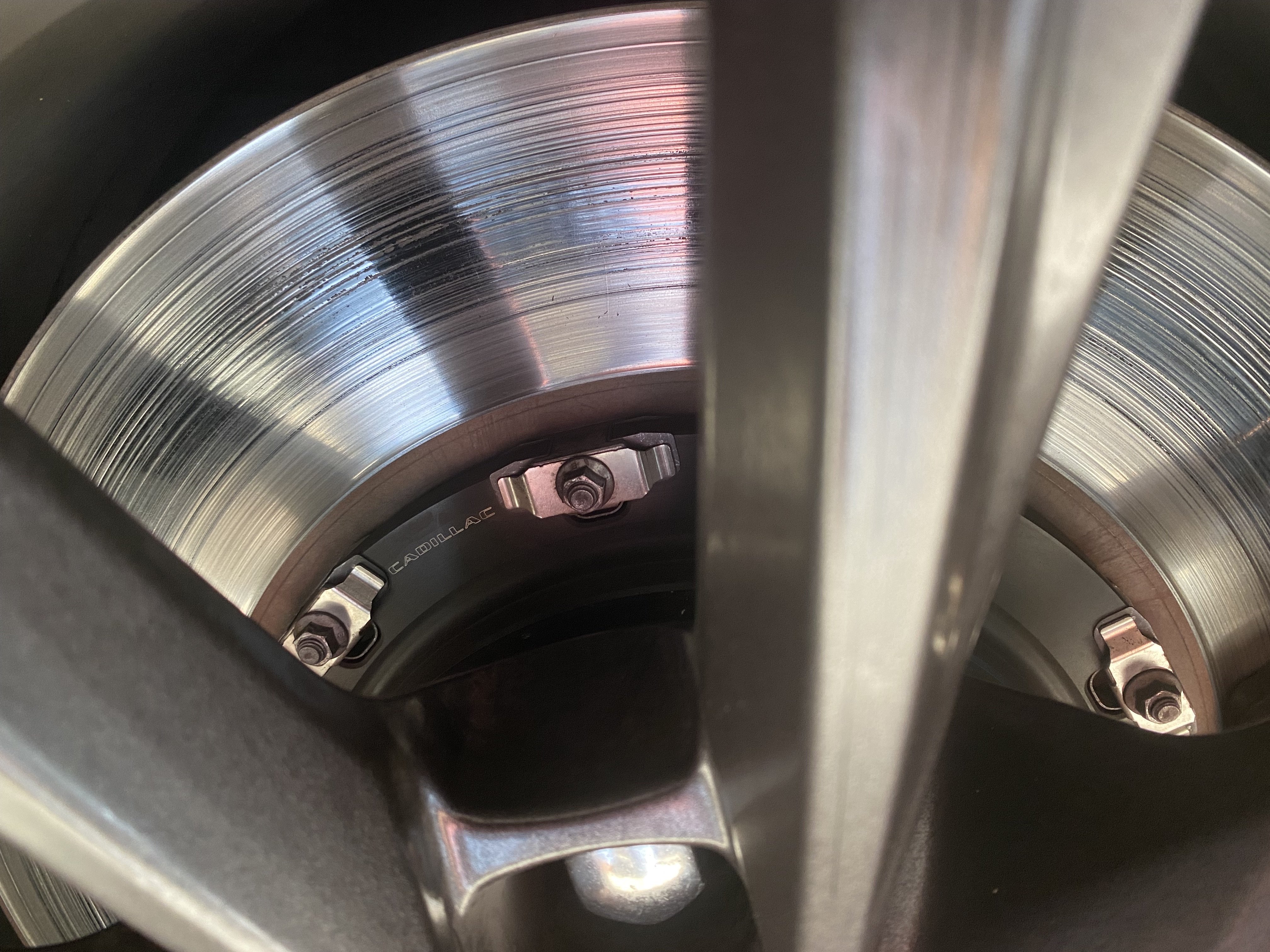

Although the stock pads stayed intact, they had mini crumbles falling out of them. Since the stock rotors are not slotted, I got some bad 1mm deep grooves in my rotors (see pic below). I replaced the pads, but the brake judder is pretty bad right now. I hope it will go away with some hard braking / time, because I don’t want to replace $1200 worth of front rotors right now…

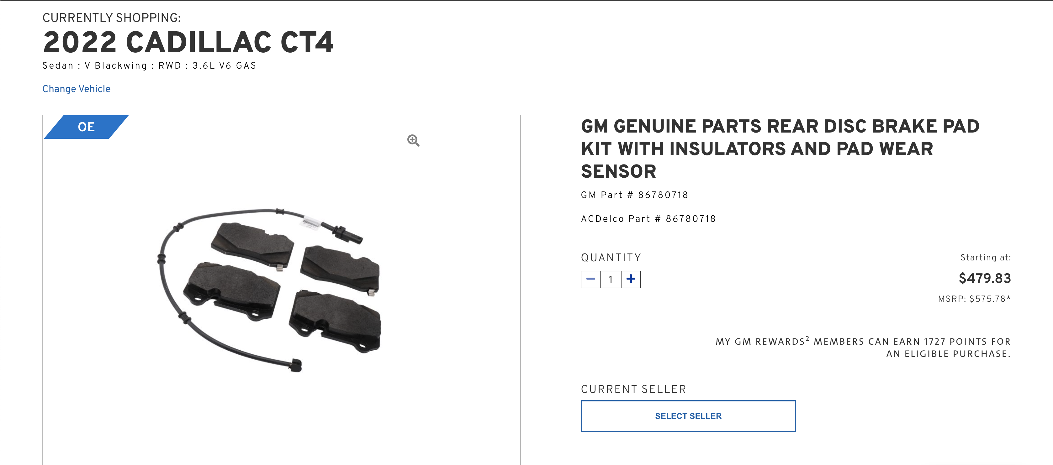

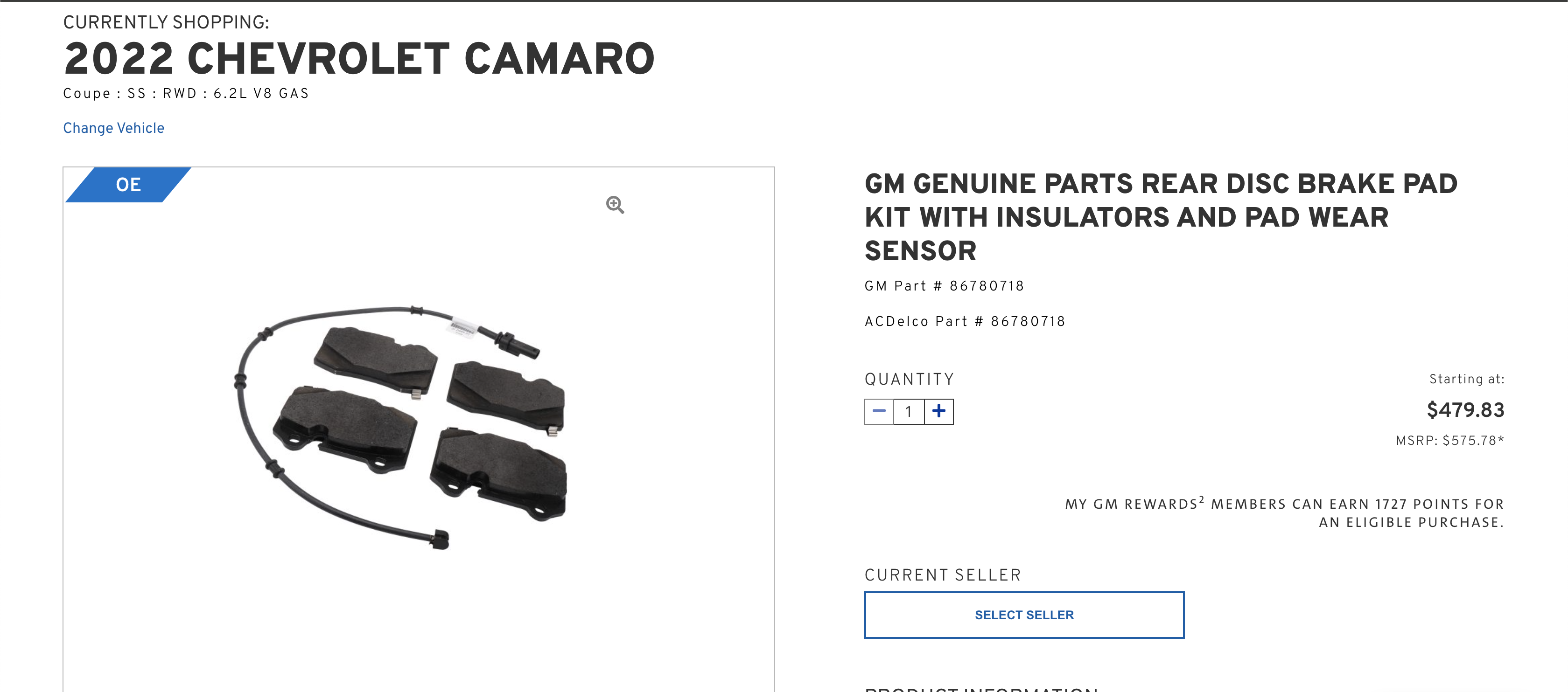

So I was digging around GM's official parts site and the rears for the 4BW are the same as the 2022 Camaro SS. See screenshots below. So I think you can get a full set with the 1LE/Grand Sport fronts and the 22 SS rears from companies. I wasn't able to find matching part numbers for the fronts with any other model, doesn't mean the 1LE/Grand Sport fronts wont work, just that GM has different part numbers.
Rotor update:
As noted above, after my track weekend I experienced bad brake judder.
I've tried to re-bed my pads several times....didn't help. I've tried to hone the rotors....didn't help.
At the end I took the rotors to a local shop to get resurfaced (you wouldn't believe how hard it is to find a shop that is willing to do it). The rotor was almost too big for the machine. $130 later I got a smooth set of rotors and the judder is gone!!!
The tech said he had to shave a total of 0.3mm. I measured the rotors when I got home - thickness is 33.3mm. New set is 34mm and minimum thickness spec is 32mm. I'll take it!!! I almost ordered a new set.
So the track day itself wore off 0.4mm. If you avoided the scoring, you would get 5 track days out of a set of rotors before having to replace them.
