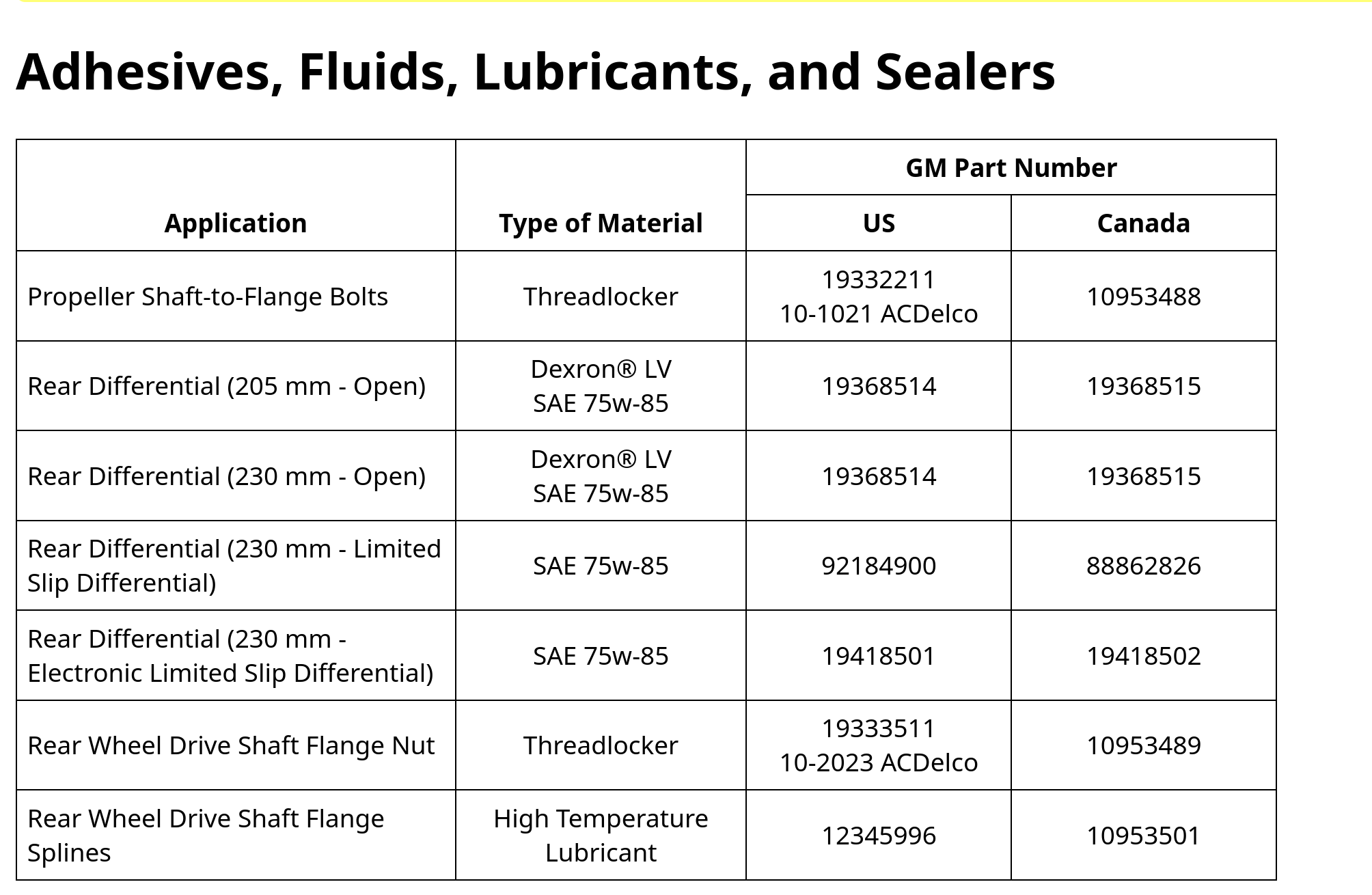

This might help:

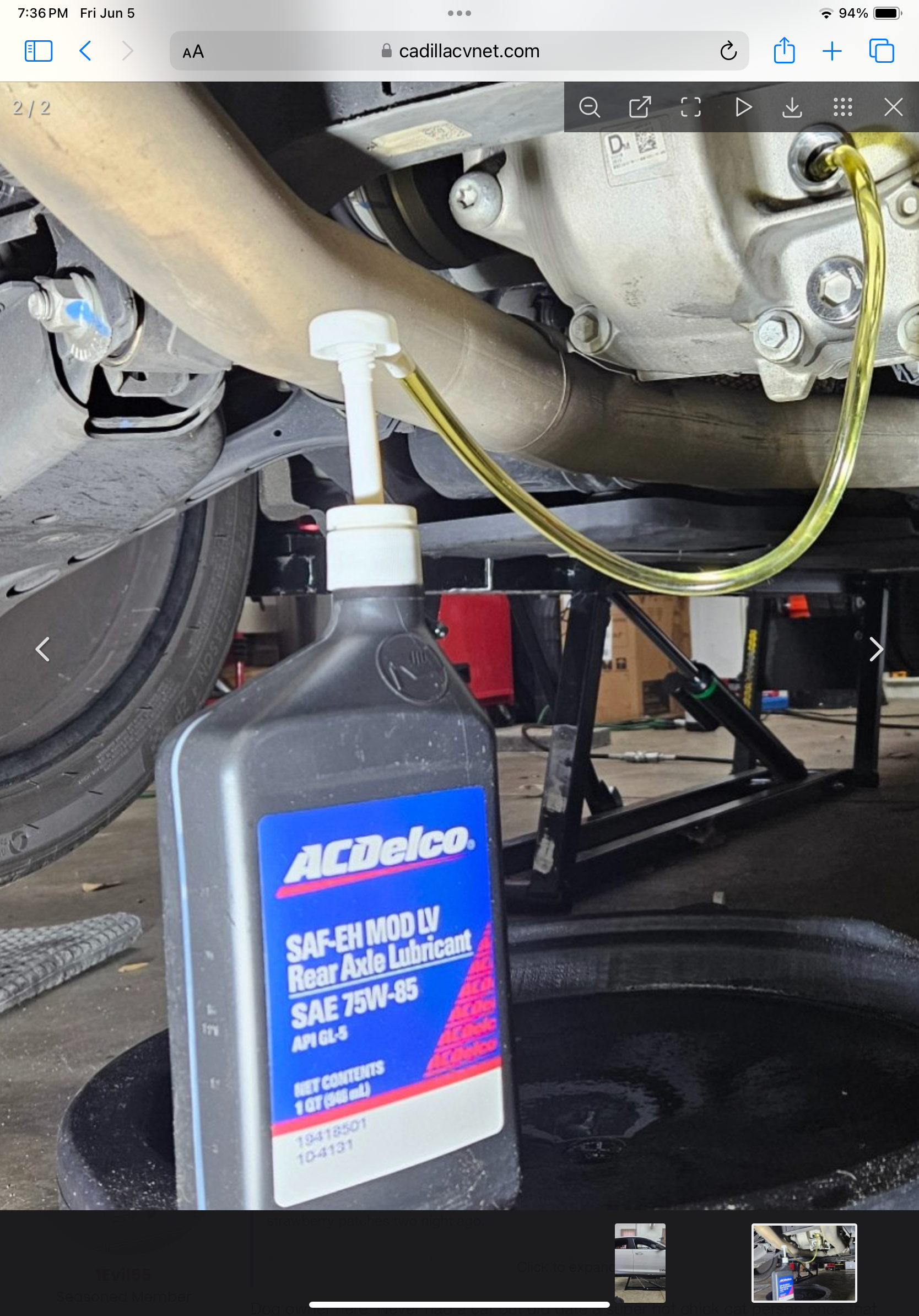

Thank you for the info, it was very helpful. I attach a picture I found of the AC Delco SAE 75w-85 oil.

Very easy to change. I didn't even jack it up and my fat ass had enough room under there.
