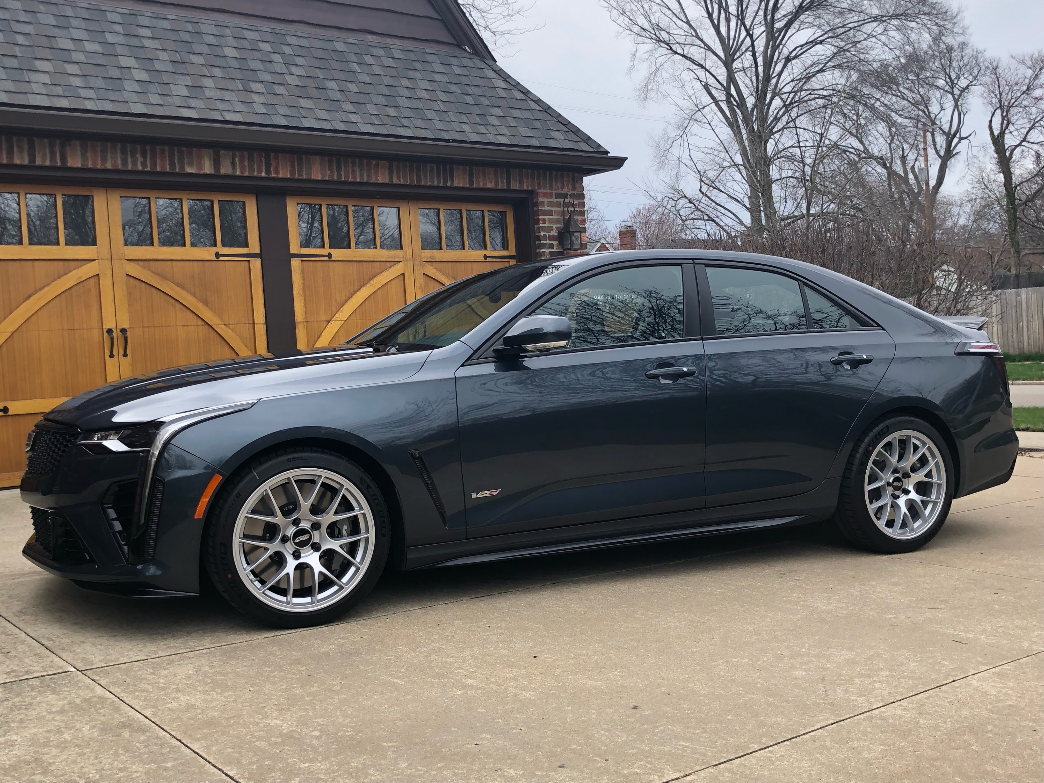

5x120 is correct, the 72.56 bore BMW sized wheels work. Our bore is either 66.9 or 67.1mm. I found conflicting info on this so I am not using hub centering rings. The 60 degree conical lugs will center the wheel as long as you or installer are careful. I am using the APEX brand EC7 wheel in the exact sizes you mention including the 3mm front spacers. To make sure I had enough thread engagement using the slightly thicker wheels and especially with the front 3mm spacers, I used Gorilla lugs 26148ETBC nuts that have an extended thread design.
Yep. I'm going to use the Apex EC7 as well, with centering rings.
Thanks for the link to the lugs ... I'll snag some of those as well! Thank you!
@Kanetch That looks really good!!
You should post this pic over in the Blackwing forum so others don't miss it. I think this section is for the non-BW CT4-V & CT5-V.

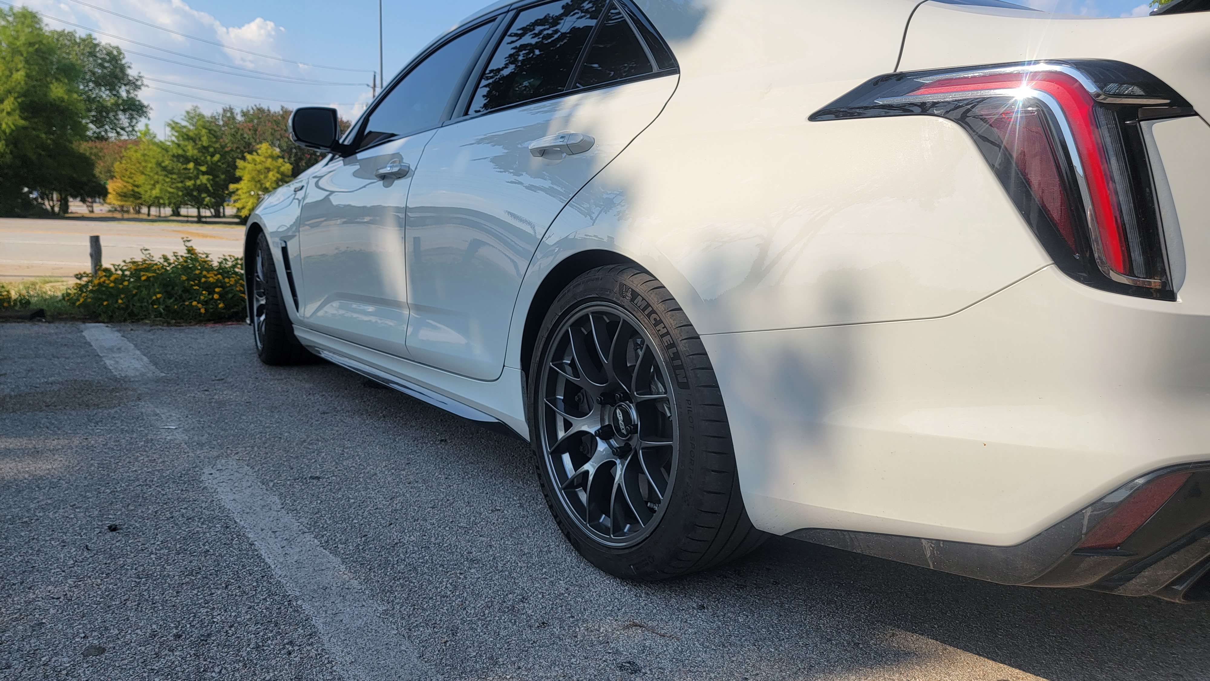

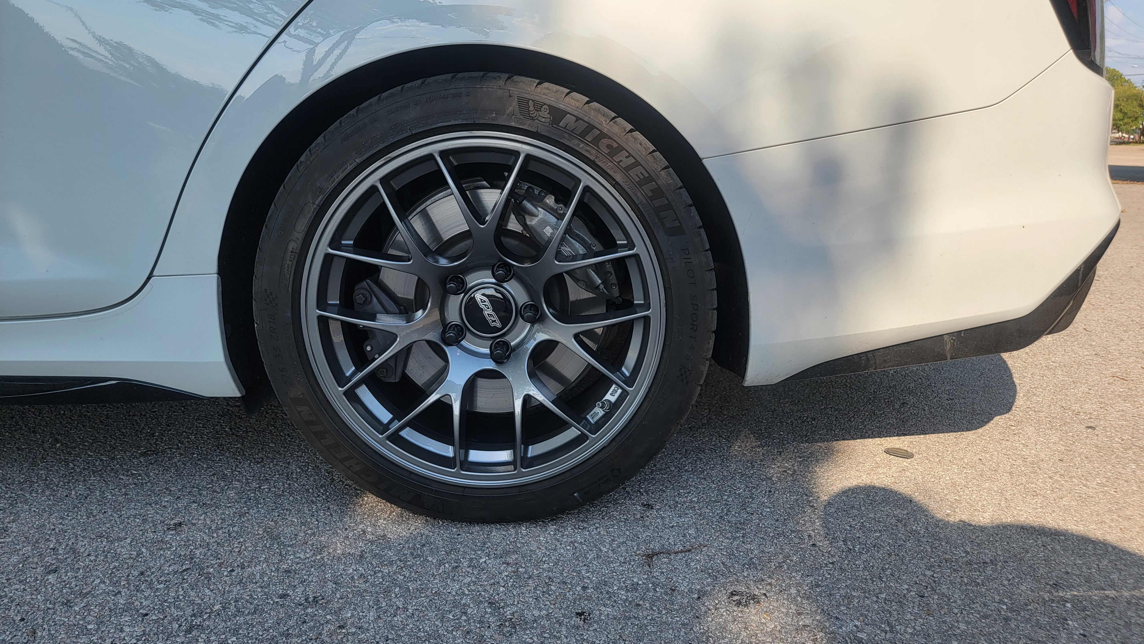

Follow up. Apex wheels are on. Working great, looking great. No issues.
