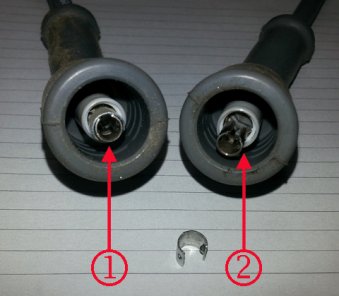

SES lamp on, DTC*P0300 - P0308*may set, inspect for a possible loose sparkplug wire at the ignition coil. *
Recommendation/Instructions
</dd></dl><dl>
<dd>
If a loose sparkplug wire is found, inspect for missing “C” clip on wire end that connects to the ignition coil.
Replace the sparkplug wire if you find the “C” clip missing or damaged
If this concern is not found reconnect the sparkplug wire to the ignition coil.
attachment.php
  1. Shows a good sparkplug wire.
  2. Shows the wire with the C clip missing.
