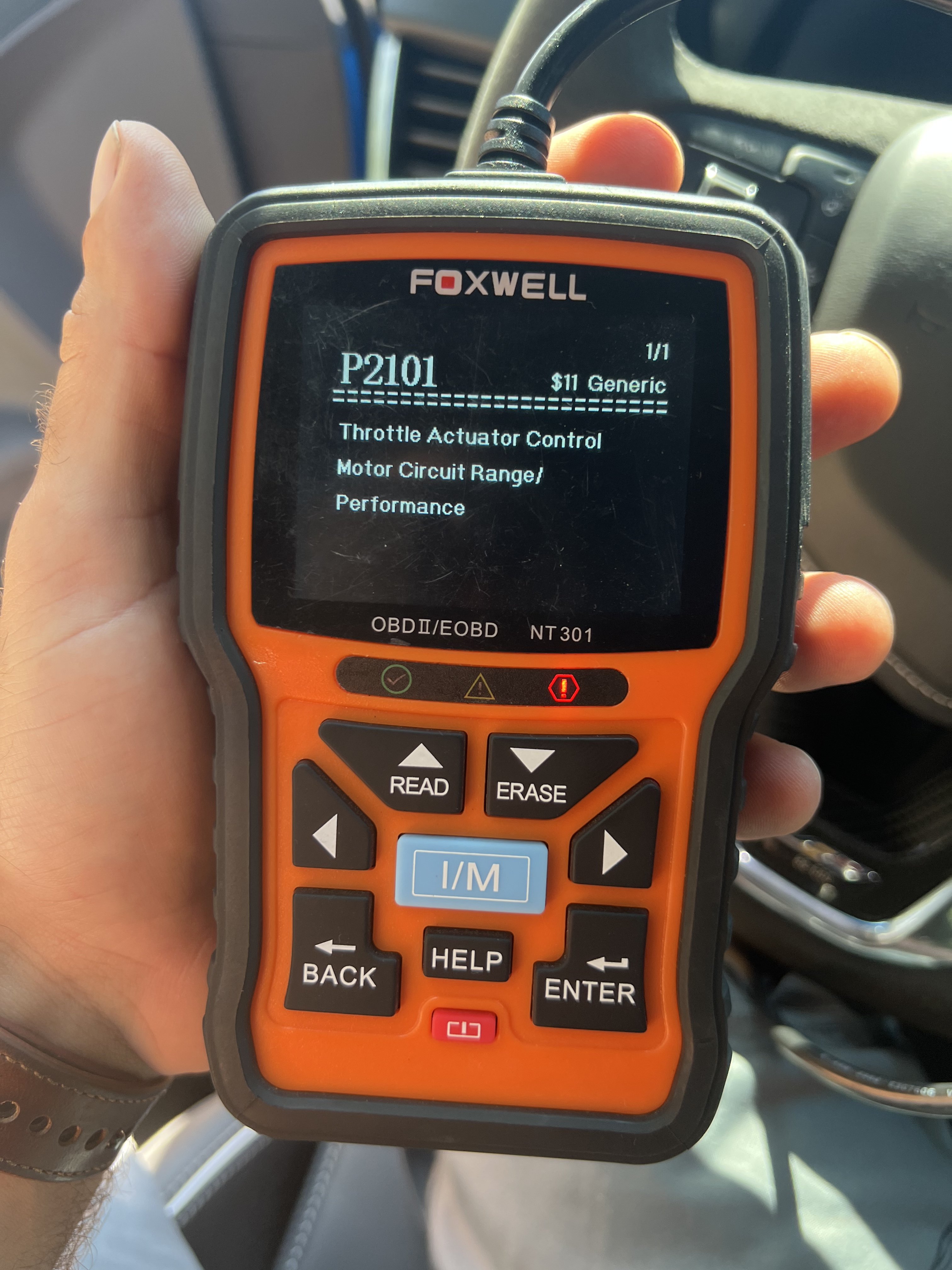

I was driving my car today when out of the blue it started to shake and threw an engine code. It had maybe 10% of the usual power.
Ran the codes and it showed throttle body actuator error
I pulled off the intake and noticed that no matter the throttle the TB would not move. It stayed shut.
I then hooked it up to a scanner and tried to open throttle body. No matter then input it would not open. I ran the gas pedal as well but it was functioning properly and sending the correct signals.
Throttle body has about 6k Miles on it. I did not even know this was ever a failure point people in counter.

The throttle body connection on the side has to be bent kind of awkward to get it to fit. It may have pulled a wire out.
Not sure if they changed the connectors on your particular one but mine had to be modified slightly to get it to plug in. Im willing to bet the issue resides there.
