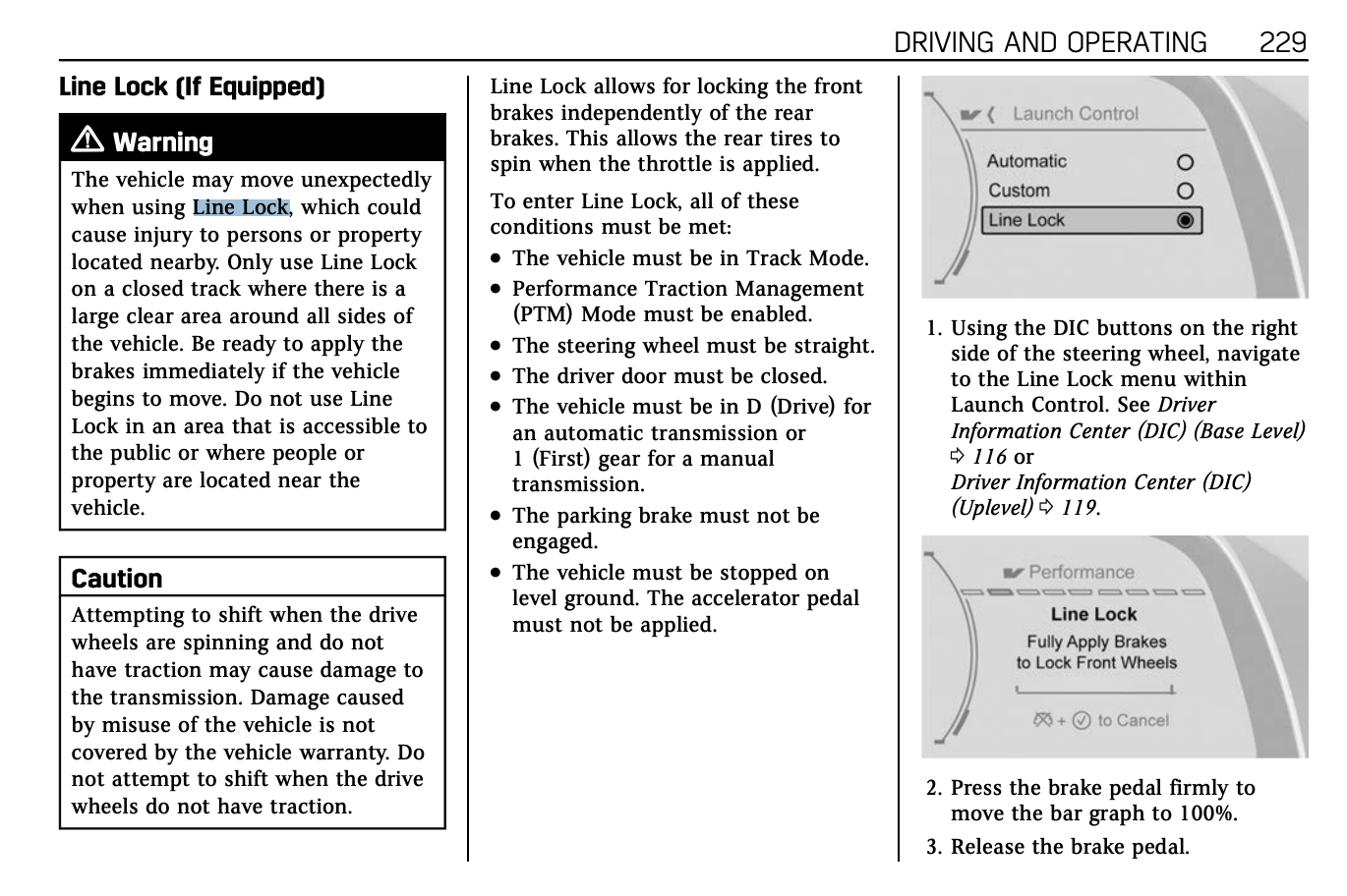

LC and Line Lock is only available in Race 1&2 IIRC. If you are in Race 1&2, you should be able to scroll to the Line Lock screen and it will be available.
see the screenshot from the manual

You can actually get LC in any mode as long as PTM is enabled. I was talking just about line-lock in that particular instance.
I don't believe you need to be in the Race track modes? IIRC you just need to have one of the PTM enabled. I thought we did it in Sport at Spring Mountain?

2025 BW with Precision Package LAUNCH CONTROL - Somewhat Figured it out, I think this is the or my additional checklist after you press the Launch Control Button and the options are not highlighted for use: Must be in TRACK Mode, before you put it in V-Mode. Make Sure your Seatbelt(s)are/ is on; I had my dog in the back had to fake click it (No I didn't LAUNCH with the Dog in the Back !) Steering Wheel Straight, foot on Brake, nothing in front of you, played with Traction Control Button (Held it Down until both Traction Control and Skid Control light came on (see pic attached) until and my options Finally Highlighted. You can choose AUTO or CUSTOM LAUNCH, and LINELOCK is also available to warm and wear out your tires ! P.S.- Love the Linelock prompt ! (see pic) "Release Brake. Floor it."
